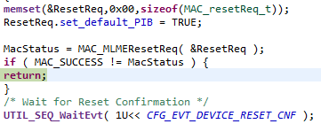

I'm using the STACK "stm32wb5x_Mac_802_15_4_fw.bin"
on the STM32WB55 and in principle it works correctly.
The problem is that after a few hours and after having been working correctly it seems that the cortex-M0 does not answer to the cortex M4 and I get blocked.
The only way to make it work again is turning off and on the STM32WB55.
I attach some code where you can see that when doing the RESET the return is MAC_ERROR instead of MAC_SUCCESS.
When this error occurs I have tried to execute the functions:
HAL_Init();
Tune_HSE();
SystemClock_Config();
But it is still blocked. What can I do in this situation to unblock and start working without turning off and on the microcontroller?

Hello, if the corporcessor firmware version is 1.13.3 , i can confirm that i have faced such behavior also, after a non determined amount of time ( and after sending frames in the order of 20000-25000 mac 802.1.5.4 frame ) ​the CM0+ crashes and start sending confirmations with non zero codes.
