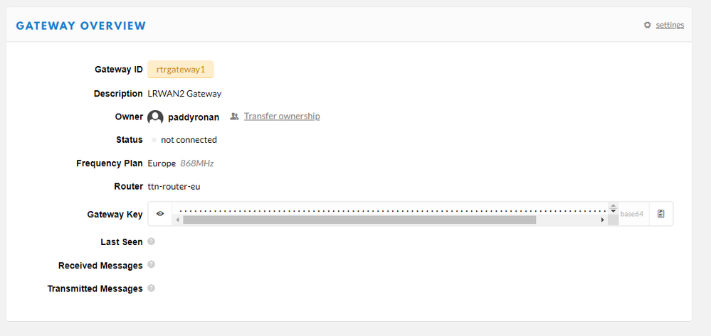

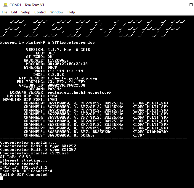

1: how do i get my gateway to be connected 2: do i need to use at commands on the I-Nucleo to communicate through it 3: how do i know if the I-Nucleo is sending it data? 4: how do i know if the gateway is receiving any data?
PRona.1
Hi All,
I am quite new to LoRa so if I am in the wrong forum area I do apologise. If anyone has any information based on my issues below I would appreciate a reply.
I have followed the setup guide from STMicroelectronics for the P-Nucleo-LRWAN2:
I have loaded the following bin file to the gateway: st-nucleo-lora-gw-at-fw-v2.1.7-eu868-TTN.bin
I have loaded the I-NUCLEO_LRWAN1 with the AT_Master firmware as instructed.

Even though, I'm not clear for the kit, I could use the sensor node as it was (default, EU868) while I could configure the gateway with AT commands. The sensor node could send some data to 'thethingsnetwork) via the gateway. To do that, I have just referred the attached manual from p. 37~41. Based on my short experience, I would like to share my idea on your recent question as following:
" For instance, they do not explain the communication between the I-NUCLEO-LRWAN1 shield and the NUCLEO-L073RZ board, the End Node app is target for the shield or for the NUCLEO-L073RZ board?"
-> UART. AT Master project is the only project for the NUCLEO-L073RZ board and the I-NUCLEO-LRWAN1 shield.
If you still needs any answers for your original questions, let me know that then I'll try to share my idea.
Yes, as the USI module is stand-alone, comes preprogrammed, and supports interaction via AT commands. You should review USI manuals as to the functionality and AT command support available/implemented.
It is possible to fork the LRWAN software and build code for the USI module, but this requires replacing the firmware on the module, and porting to the specific pins, and SX1272 connectivity. If you go down this route you won't be able to go back to USI's software load.
