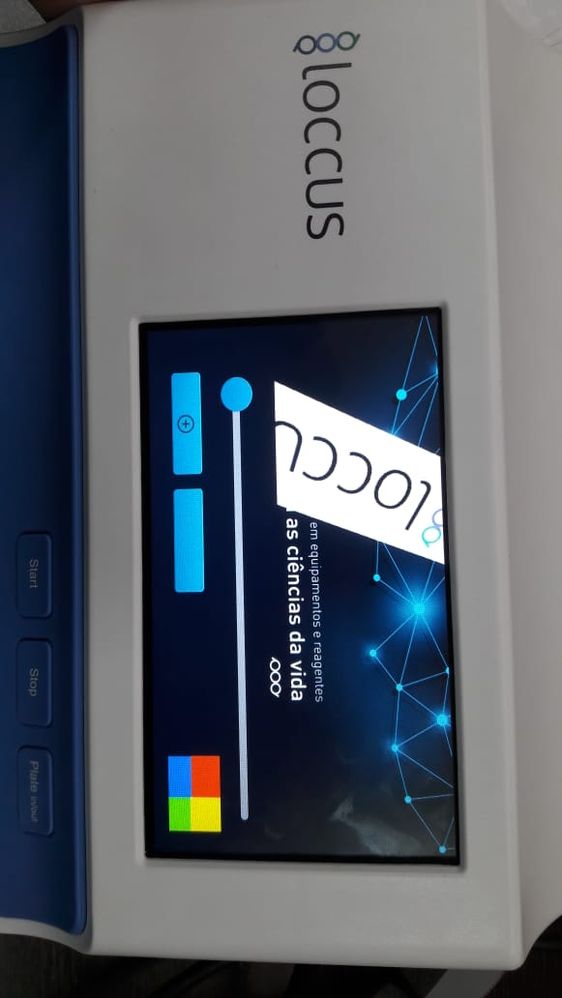

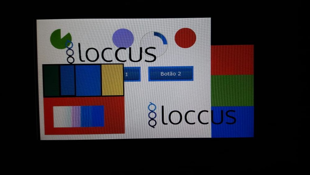

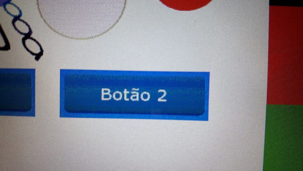

Hello i'm porting TouchGFX to a custom board using STM32F429 and a custom 800x480 16bit display.
I'm having trouble when I try to add a .png image on the TouchGFX designer. For some reason, if the .png file have any gradient effect, the resulting image will not display correctly on the physical display.
Here are some examples:

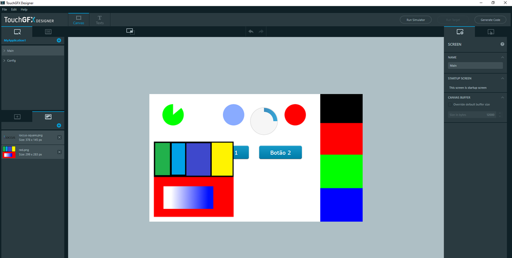

This is the example application i'm trying to show on the display.0690X00000AANvYQAX.png
This is how the colors are displayed on the physical display:
Notice how the gradients effects are displayed on the display.

I don't think anything in your configuration stands out. Could it be your RGB connections to the display? Do you actually have 8 linesfor each color?

You cannot represent gradients well with RGB565. Try switching to 24bpp (Depending on how your project is setup up you may also need to manually declare the lcd class as LCD24bpp instead of LCD16bpp).
user_cflags := -DUSE_BPP=24
There's no way around that. Either use 24bpp, accept less than perfect gradients or use assets that don't have any gradients if you want it to look good, but can't afford a 24bpp framebuffer =)

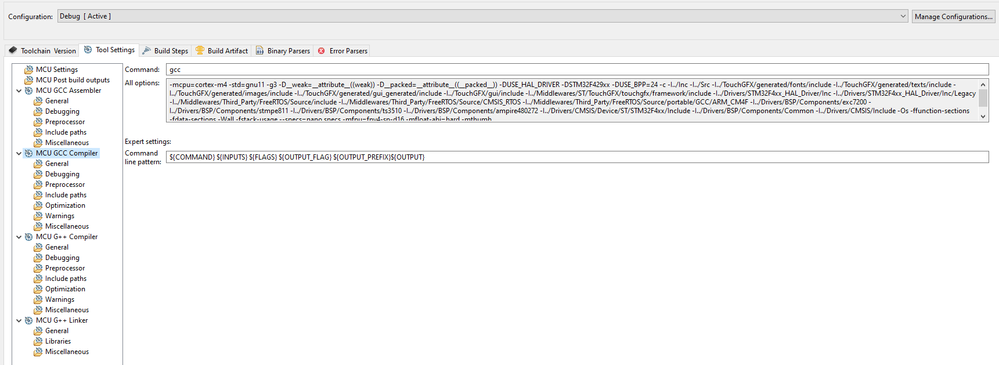

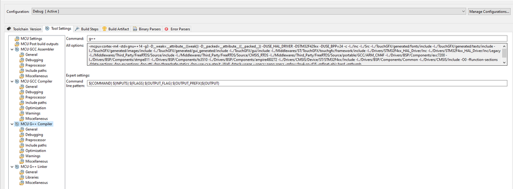

Hello @Martin KJELDSEN​ , I've changed to an 24bpp display but i'm still not representing gradients well.
I'm not sure if I'm using the right configurations for my application. I'm using STM32Cube IDE.
Some of my configurations:

Hi Martin, you nailed it. Yesterday I revised the LCD GPIO configurations and turns out some pins were wrongly assigned. I fixed and the display is working properly with the gradients now. This was very tricky because since solid RGB colors were fine and we got confused thinking that the display didn't support RGB888 colors.
