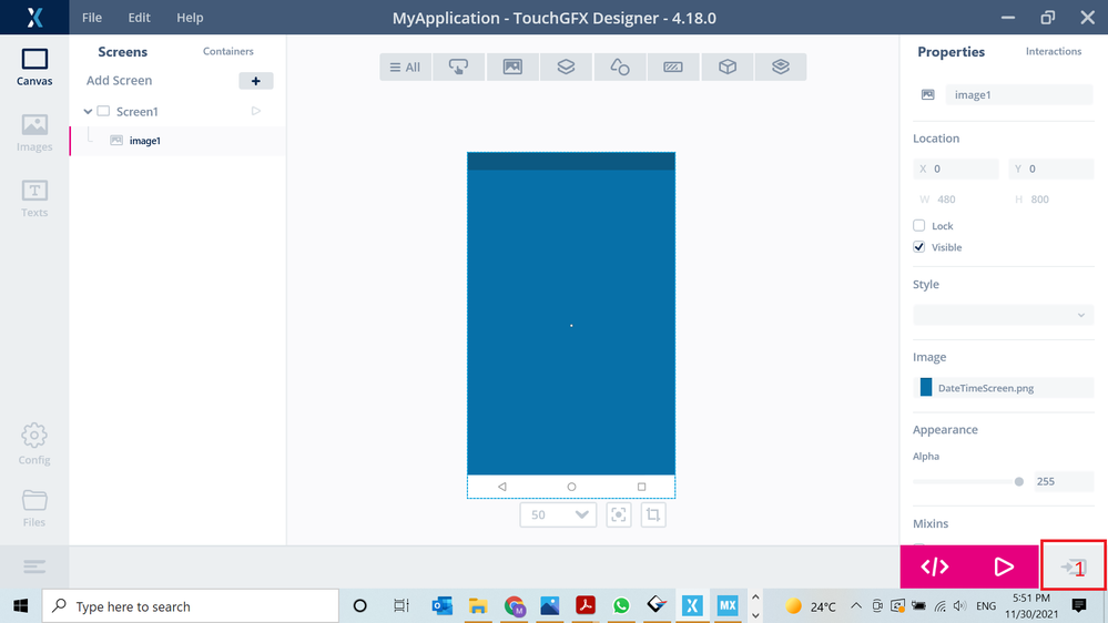

i am using touchGFX designer V4.18.0. In software run target option is disabled.
how can i recover that so please tell me the process to get run target option.

0693W00000GZW8aQAH.pngPlease check in picture.

Target enabling is based on enter comands in config build
0693W00000GZXM5QAP.pngin normal project generated from .part file have this empty

i got this error making run target
Compile
    make -f ../gcc/Makefile -j10
    make: ../gcc/Makefile: No such file or directory
    make: *** No rule to make target '../gcc/Makefile'. Stop.
    Failed
  Failed

Actually i am using STM32F469I-Disco kit . when i add usb virtual com port in cubemx i got compile error in touchGFX but no error in stmcubeide.
at that time based on Community member instructions
I did the below process.
took a stmcubemx .ioc file from my old project because of some usb related errors in touchGFX.
Copy that file in to a new floder
Opened & Generate code again.
Got TouchGFX .part file & stmcubeide folders.
Opened .part file & browse my old touchGFX file
So at that time only I lost run target option in my touchGFX designer.
after now
now add (copy) the build commands. I got run target option but make file error is coming as we discussing about that
Compile
    Failed
  Failed

JimFouch
Looks like you have one or more images that have an issue. If you notice in your attached screen shot there is a red bar next to your images.
I had this happen. My issue was an illegal image name that included a space. Once I renames the image file to not have a space and reloaded those images, I could then compile/run on target.
