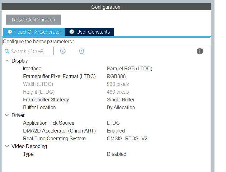

Why does uwTick stops incrementing after calling MX_TouchGFX_Init();
manto.1
Senior
I started the project configuration from scratch, using
  • STM32CubeIDE 4.20.0,
  • STM32CubeMX 6.6.1
  • TouchGFX 4.20.0
Timer 7 is used for Systick.
int main(void)
  /* USER CODE BEGIN 1 */
  /* USER CODE END 1 */
  HAL_Init();
  /* USER CODE BEGIN Init */
  /* USER CODE END Init */
  SystemClock_Config();
  /* USER CODE BEGIN SysInit */
  /* USER CODE END SysInit */
  MX_GPIO_Init();
  MX_TIM1_Init();
  MX_FMC_Init();
  MX_LTDC_Init();
  MX_TIM4_Init();
  MX_QUADSPI_Init();
  MX_DMA2D_Init();
  MX_CRC_Init();
  MX_TouchGFX_Init();
  /* Call PreOsInit function */
  MX_TouchGFX_PreOSInit();
  /* USER CODE BEGIN 2 */
  HAL_LTDC_SetAddress(&hltdc, (uint32_t)framebuffer, LTDC_LAYER_1);
  HAL_GPIO_WritePin(LCD_EN_GPIO_Port, LCD_EN_Pin, GPIO_PIN_RESET);
  HAL_GPIO_WritePin(LCD_RST_GPIO_Port, LCD_RST_Pin, GPIO_PIN_SET);
  HAL_Delay(200);
wired
Senior III
That particular mix of software tools is incompatible. I had the same thing happen to me, and I have a separate discussion on it here. When you compile the code in CubeMX, it generates incorrect code for Hal_InitTick(). What I ended up having to do is to paste the function from CubeMX 6.5.0 into the auto-generated file every time I compile the .ioc file. I am attaching the file so you can see what I do. the commented out function is the one auto-generated by 6.6.1, and the uncommented function is from 6.5.0.
Try using the function from my file and see if it solves your problem (you will have to modify to use Timer7 instead of Timer6).
