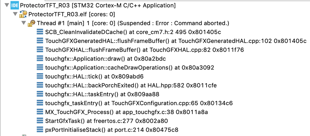

Just noticed that my application TouchGXF task hanged. Other FreeRTOS tasks are continue to work.
Debugger shows that problem is within core_cm7 SCB_CleanInvalidateDCache():

Task stack:
‎2022-01-21 12:49 AM
