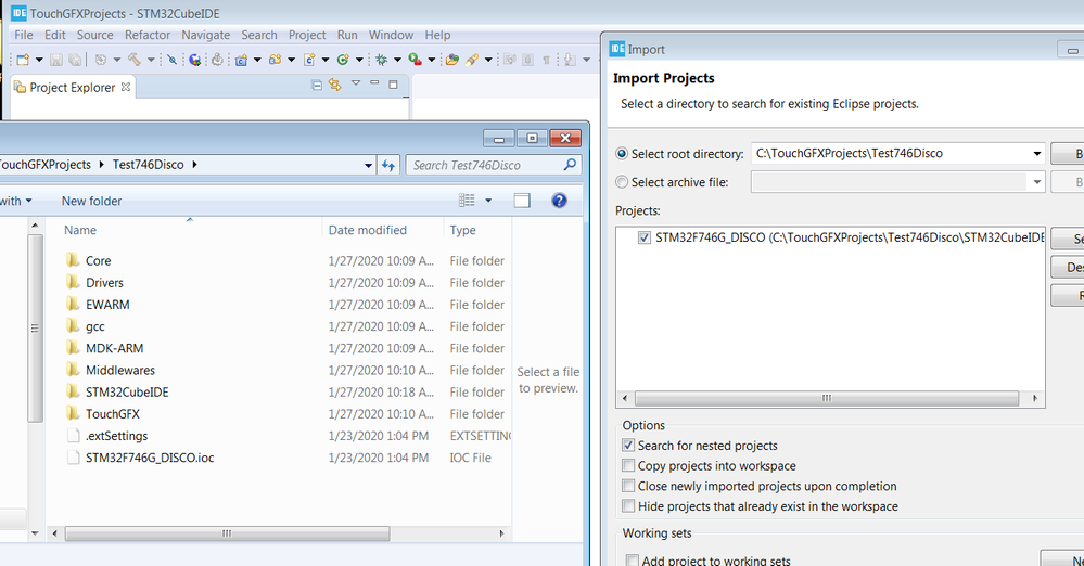

0690X00000Bwd1cQAB.pngThanks for your patience. Details: GFX v4.13.0, Cube IDE v1.2.1 (latest updates of which I am aware).
Unfortunately, the system behavior has not been consistent over all the trials run, but the result is about the same each time. Here is a typical scenario, which I verified three times just now:
1) Using the Designer, I select a V3.0.0 template. I name my project something like "TestDisc746". Designer creates all necessary code, and I can run it on the target board from Designer.
2) I can import this newly created project to the IDE, at least sort of; everything except the GFX folder(s) containing the code needed for further development is brought into the work space. That is usually just a folder structure thing, and I will normally add such folders manually in the IDE, but trying this results in build errors of various types, even after excluding the simulator related files from the build. [Also note that Designer always forces the application name to be "STM32F746G_DISCO", regardless of what I call it when creating it; this is okay so long as it also names the project folder the same, but on occasion it has not, causing an import error. This happened several times last week, but so far not today.]
I suspect that getting the full project into the Cube and building it is a simple process, to judge from your comments, but I'm not seeing it. What is the final step in the process to get that Designer project into the Cube IDE, complete with the GFX files, so that they build error free? I am attaching a screenshot showing both the directory structure that has been created and the IDE import dialog.

Martin, I now see part of the problem. The GFX stuff is being imported, but the directory structure is different between those projects created by GFX and the ones generated in the Cube, and that is why I was not able to see the files where they used to be. I will start fresh with this in mind and see if I can get this to go.
Okay, great. This different structure sounds weird, and i plan on taking a look at it. I think i mentioned that i find it weird because the AT is based on what comes out of CubeMX/CubeIDE.
/Martin
