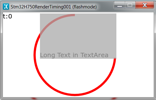

When they touch (even just edges) the invalidated rectangle encompasses a large area (seen by pressing F2 when running the simulator).
In my handleTickEvent() function, I am updating one item in that tick event only. The next event I update the other item only. I didn't think it would redraw a large rectangle because they would be rendered at different times, but it is. I slowed it down so that it only updated every 30 ticks. I also placed a touchgfx_printf() in each item's update code to verify only one item is updated at a time.
When are invalidated areas re-renedered? It appears that they aren't re-rendered at separate times but at the same time.

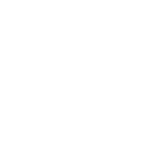

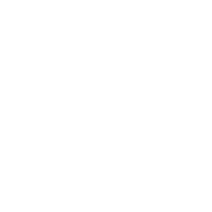

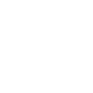

The first frame looks like this (the whole frame is invalidated):
0690X000009ZcO9QAK.bmp The second frame looks the same:
The reason for this second full update is that I am using double buffering. The whole updates done on the previous framebuffer must be applied on the second buffer also.

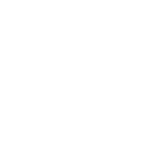

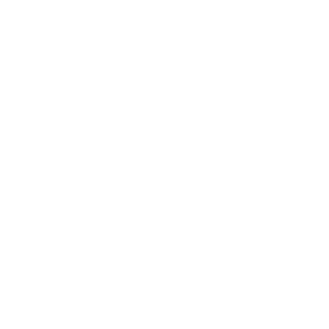

In frame 5, we update the start angle on the circle. Again we get updates in two frames:
Only the little piece of the circle was redrawn.

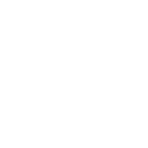

In frame 10 I change the color of the TextArea and invalidate that:

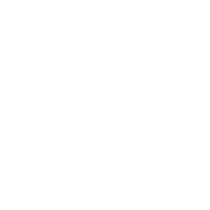

In frame 15 I change both the start angle and the end angle of the circle:
The TextArea is not invalidated here.
If you have seen that invalidating the Circle also redraws the TextArea, it could be because of double buffering, that requires the framework to repeat a change in the first buffer also in the next buffer.

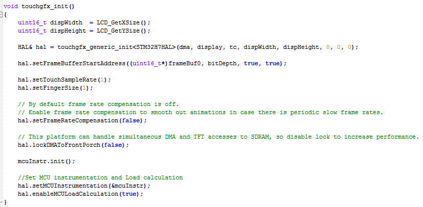

Thanks for your reply. I am using the STM32H750-Discovery kit and have not changed any of the configuration. From what I see in the file BoardConfiguration.cpp, it is set up for double buffering:

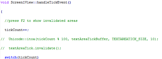

However, I do not think this is the issue. I made a project like yours (including changing the Vsync interval on the simulator). It appeared to work like yours until I did one thing. I commented out the invalidation of the textAreaTick because mine will not have this:
When I did this, I was seeing the same thing that I was with my project (tickCount not being invalidated):

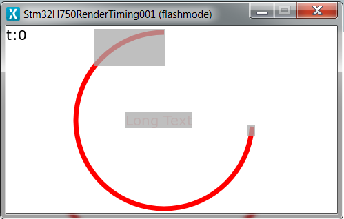

I understand that if it's a big block and overlaps, it needs to redraw all of it. This is the reason I am alternating the invalidation of the different items. The issue I am seeing is that they are invalidating at the same time when they should be alternating. The code is the same exact as yours as I copy/pasted your handleTickEvent() into my Screen1View.cpp file. The rendering alternates as expected. However, If I comment out the invalidation of the textAreaTick, it does NOT alternate but happens at the same time.
I reduced the size of the inside text area to ensure there are no overlaps and ran it again (with the invalidation of the textAreaTick commented out) and as you can see, they are happening at the same time (even with no overlaps):
Would it be possible to for you to comment out the call textAreaTick.invalidate() in your code to see if this happens for you as well?
​Hi Scott
Yes, if you do not invalidate the TickTextArea in every tick, then you get the TextArea and Circle redrawn in the same frame. This is due to double buffering.
In frame 10 we invalidate the textArea. This causes the textArea to be redrawn in the current framebuffer (call it FB_A).
In frame 11, 12, 13, and 14, nothing is invalidated, so TouchGFX does not draw anything.
In frame 15 we invalidate the circle in both ends. This causes the circle ends to be redrawn in the current framebuffer (FB_B). Since the textArea is not correct in FB_B (was updated in FB_A), it is also redrawn in frame 15.
