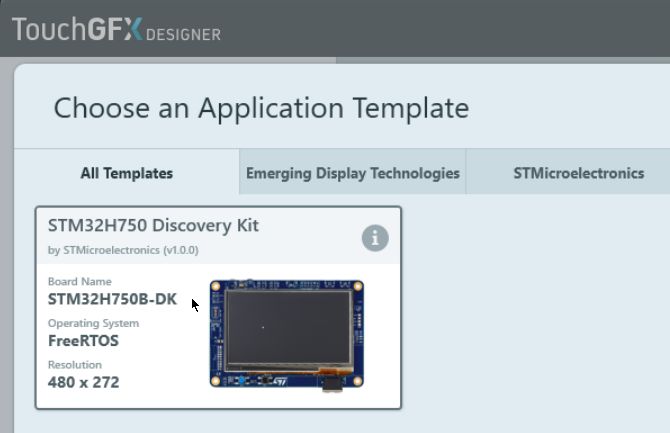

what is the procedure to use STM32H750VB with touch GFX

Hi @NGond​,
Actually, we just uploaded an H750 application template that should be available through the designer now. Check it out and let me know!
/Martin
‎2019-06-12 2:47 PM
This is the H750-DISCO, though.
‎2019-06-14 4:21 AM
To summarize:
The procedure for the STM32H750VB is the same as for STM32H750B. H7 graphics will not be available through CubeMX for a while, i think, so you cannot go that route. Are you looking at a custom board here?
