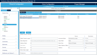

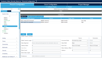

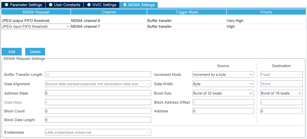

Could you please change the priority of JPEG input and JPEG output similar to the picture below?
I think you also need to change the Burst Size of JPEG input as well. (similar to the picture)
JPEG settings in MDMA

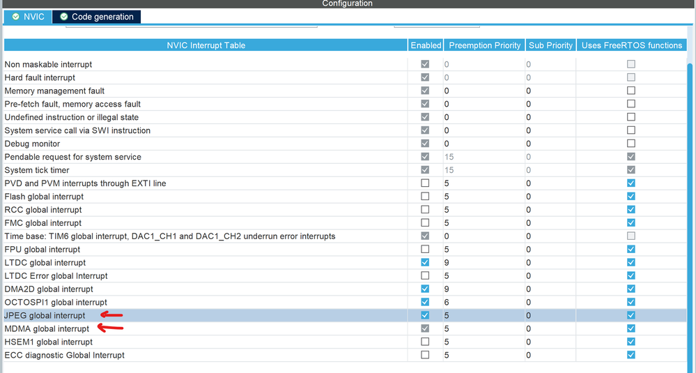

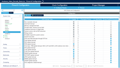

Also, ensure that the JPEG and MDMA interrupts are enabled with correct priority, like this:
Please try these settings and let me know about the results.

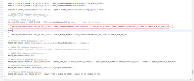

‎2024-07-10 6:27 AM
Hi @Mohammad MORADI ESFAHANIASL
This is the working "directframe to buffer" configs.
This is the "double buffer" configs.
And the result;
‎2024-07-12 3:22 AM
Thank you for sharing the result.
To be honest, I'm running out of ideas but it seems like there is an issue with coordinating the buffers.
I know you already have set the Video_RGB_Buffer in your linker script but, could you please try these settings as well?

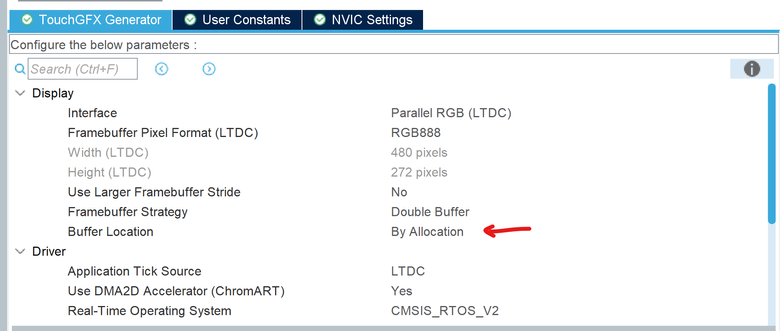

First, set Buffer Location in the TouchGFX configuration to 'By Allocation':
Buffer Location configuration
And then, add these lines to your linker script:
MEMORY
SDRAM (xrw) : ORIGIN = 0xD0000000, LENGTH = 8M
TouchGFX_Framebuffer (NOLOAD) : { *(TouchGFX_Framebuffer) } >SDRAM
Video_RGB_Buffer (NOLOAD) : { *(Video_RGB_Buffer) } >SDRAM
I know it sounds trivial but, I'm afraid that there might be an issue with the alignment of buffers because based on the YouTube video and the fact that 'Direct to Framebuffer' works correctly, the video decoding is done right, however, the coordination between the buffers is wrong causing these screen glitches.. Therefore, I would like to know whether there is an alignment issue or the way that buffers are handled. If it is the latter case, you should check the soundness of your TouchGFXHAL.cpp.
