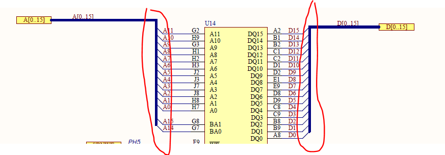

You mean these as control lines?
‎2022-02-15 7:26 AM
Well, I mean all lines carrying high frequencies: address/data bus, CLK, etc.

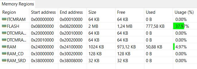

When Extarnal RAM is canceled, the touch part works but detects late. What could be the reason for this? After all, I disable external RAM and disable it from CubeIDE settings. I am removing the codes related to external RAM in the code. But the touch part works with a little delay.
I'm trying the code before enabling the external RAM to see this effect. In that code, the touch part works fine.
