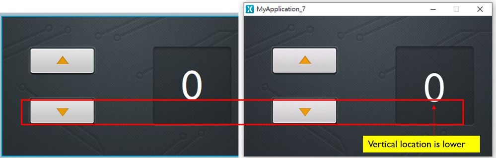

Touchgfx text vertical locations are different between canvas and simulator
JLee.32
TouchGFX Designer version: 4.13.0
I follow my customer's coordinate to design the UI, and UI in the Touchgfx Design canvas looks the same as the image in Zeplin. but if I run the simulator, the text vertical location is lower.
As image below, the text vertical locations are different between canvas and simulator. When I download the code to my custom PCBA, the text vertical location on display is the same as the simulator, instead of canvas.

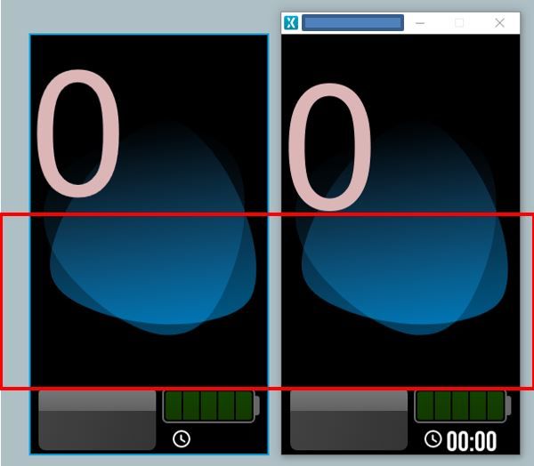

0693W00000AMiHBQA1.jpgI also try the sample code which is shown below. The vertical location is still lower. Is there any way to make them the same?0693W00000AMiJpQAL.jpg

Why 4.13? Try use latest
Romain DIELEMAN
This is a known issue where the text is not exactly displayed by the simulator... This should be fixed in TouchGFX Designer 4.17. The workaround is just to move the text a bit higher in the canvas :grinning_face_with_sweat:
