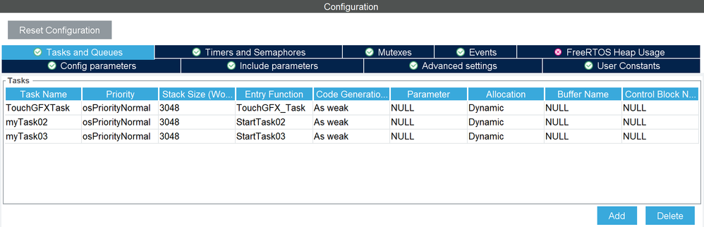

Hi, Thanks for the reply.
The TouchGFX_TASK is already defined there, so I added two more
0693W00000aJqEvQAK.pngWith this setup StartTask02() is called, the other two are not called!
The changes made are basically what I was doing manually but with a different outcome!

 /* MPU Configuration */
 void MPU_Config(void)
ACapo.1
Senior
Ok I think I have worked it out.
That TouchGFX_Task code should not be in main.c, I have no idea why it was generated there.
The actual TouchGFX_Task() is in app_touchgfx.c
Still a little strange that only one of the other tasks is being called though!
