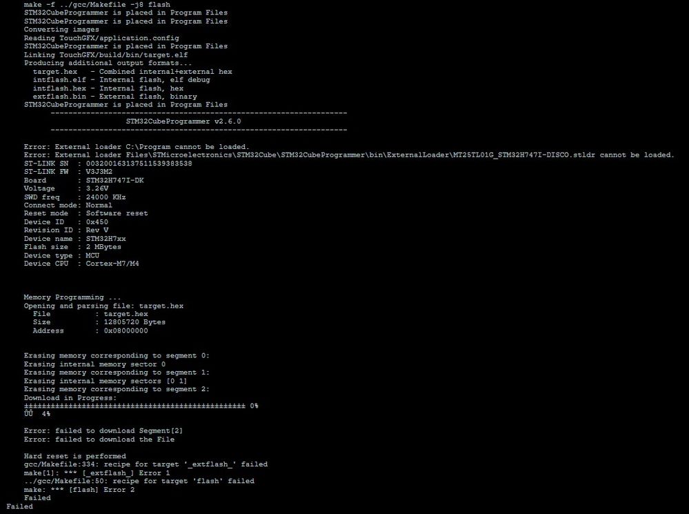

TouchGFX - STM32H747 Discovery "Error external loader cannot be loaded", this problem might conduct to "failed download Segment[2]"
SEmar
0693W000006H8WIQA0.jpg0693W000006H8WDQA0.jpgHello everyone,

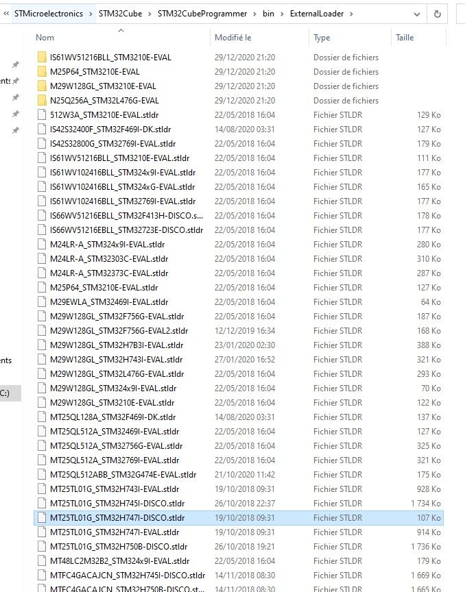

I have a STM32H747I-DISCO and I am trying to use it with TouchGFX in the first part. But the problem is I cannot use it directly with TouchGFX "Run Target" mode.
I have few errors, I tried to run as admin but it didn't work. I have the external loader file specified.
Could you help me please ?
Thanks,
Simon

Thanks for your reply, I tried the 2.5.0 version (2.6.0 before) and now it works.
Thank you.
