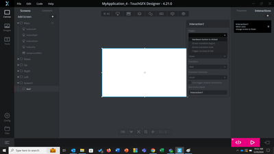

Is this available in the latest TouchGFX version? we are using 4.21.00
How the trigger is detected i.e user has performed slide from top to bottom or right to left?. Can this be done using the touchGFX designer itself using interaction section or we need to write code?
Please see attached image
Thanks
Anuj

I don't want the trigger to be on button click. I want the trigger when the user slides his finger from top edge of the display to bottom or right edge of the display to left then the screen transition should happen. In the designer I see only 4 options for trigger
Hardware button is clicked, Screen transition begins, Sceen transition ends and Trigger on every N tick
How do I achieve the trigger ?

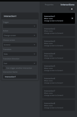

Hello Anuj
I think you must implement handleDragEvent-function to all screens for handle the draggings and then trigger slide transition from screen to another when needed.
You can easily get all transition functions generated to FrontendApplicationBase.cpp by just adding empty interactions to some of your screens like
Remember to add all necessary transitions. Then you can trigger a transition from view by calling function like:
application().gotoScreen2ScreenSlideTransitionEast();
