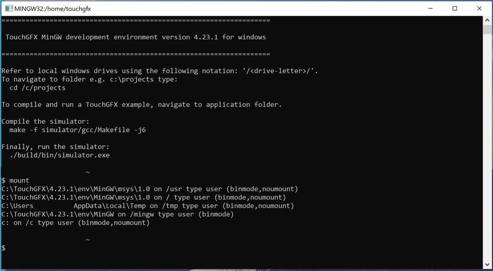

I tried to install TouchGFX 4.23.0 and 4.23.1 several times. OS is Win 11 pro eng/us region and eng language settings.
When executed the run command on windows simulator fail message appears as in attachment.
Also fails when creating any discovery board as in other attachment.
I installed the TOUCHGFX successfully  another Win 10 pro machines.
How can I fix this issue for Win 11 pro installation?

Plus, it would be nice if you can provide the TouchGFX log that is available at AppData/Roaming/TouchGFX-4.23.1, you can quickly access it from the start menu by searching %appdata% . It would be nice if you catch the log when you face those issues.
Also, could you mention the build version of the Windows 11 that you are using? And a screenshot of TouchGFX 4.23.1 Environment (you can run it from the start menu just by searching for it) running mount command, something like this:
TouchGFX EnvironmentTouchGFX Environment

4. TouchGFX 4.23.1 Environment screenshot is in the attachment.

Could you please check the version of g++ that you have? By running g++ --version in the TouchGFX Environment.
It would also be great if you try to build your project from TouchGFX Environment instead of the Designer (So, by using the command line). You can see the instruction for it here
