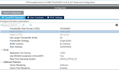

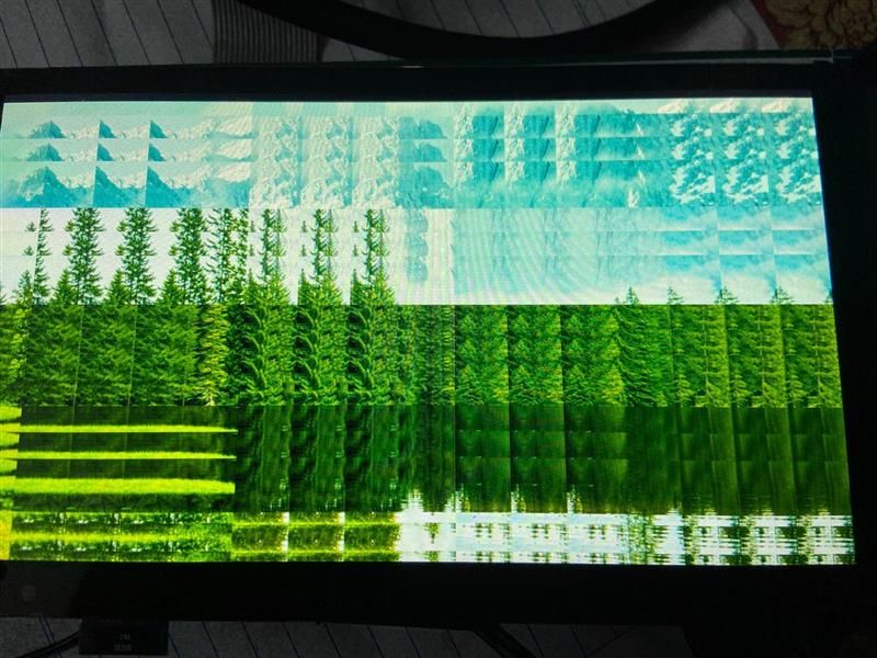

I’m working with a custom 24-bit display on an STM32H757XIH6 MCU.
I’ve configured the LTDC with pixel format ARGB8888.
When I test with solid fill colors, everything displays perfectly.
However, when I try to display an image using TouchGFX Designer, the output appears as repeated, tiled, and shifted blocks instead of the correct image.
I’ve attached a photo of the display for reference.
Has anyone faced this issue before, or could guide me on how to resolve it please Screenshot 2025-09-08 130253.png
Thank you in Advanceshifted blocksshifted blocks

rahulz916
The issue was related to the SDRAM clock, but it's been resolved now.
Thanks @LouisB

LouisB
Hello @rahulz916,
Have you check the rest of the configuration according to your screens specs? (In the CubeMX LTDC panel)
BR,
Louis BOUDO
ST Software Engineer | TouchGFX
rahulz916
Thanks @LouisB
