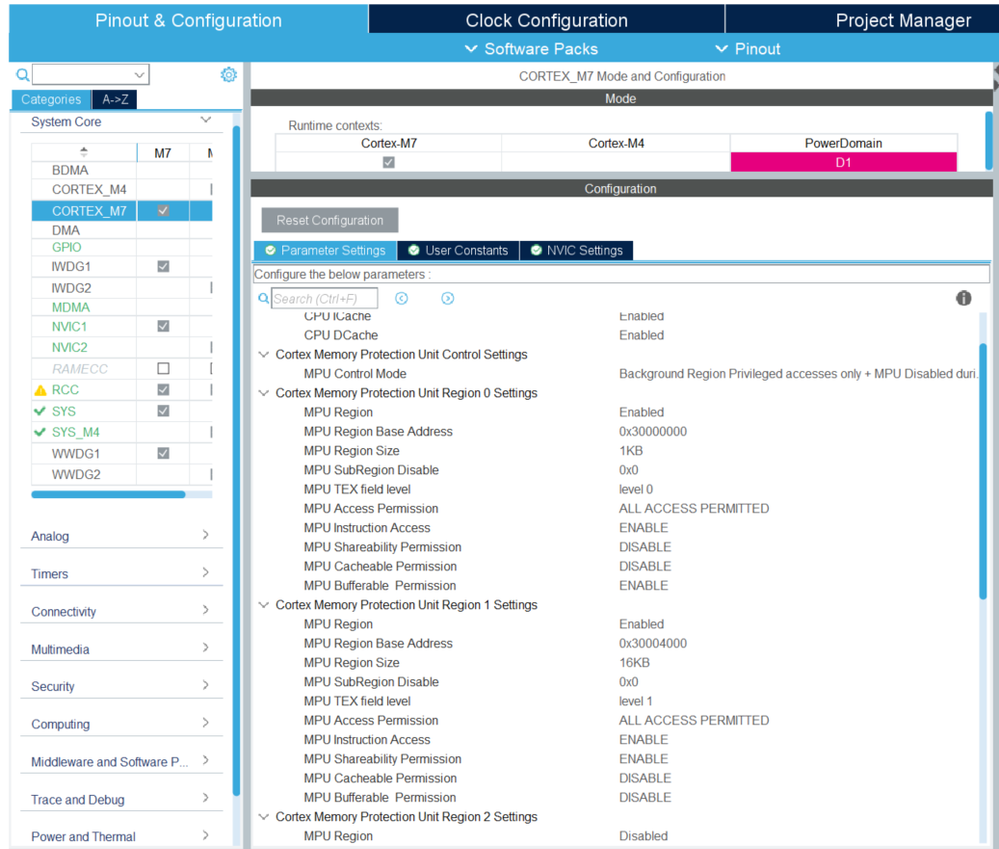

1) Configuring MPU regions like this:

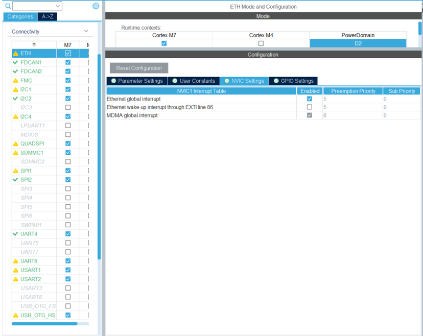

2) After that I have enable the global interrupt for ETH peripheral like this:

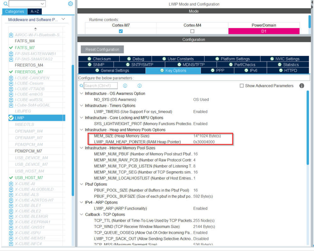

3) Subsequently in Middleware section I have enabled the LwIP, set the platform and changed only MEM_SIZE and HEAP_POINTER like this:
while I have disabled the DHCP and set my static IP Address.

I am able to ping my static IP for at least 20 minutes and After that It corrupts with a hardfault error (PRICISER), which I cannot understand why it is doing that, and also how to trace it to investigate the error. All the other parameters are left as default with the total heap size like:
#define configTOTAL_HEAP_SIZE   ((size_t)131072)
Can someone explain to me what I should do or might the CUBEMX has broken code with bugs?
