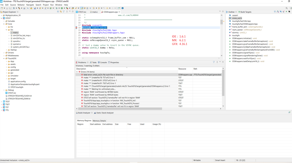

TouchGFX/App/app_touchgfx.o: in function `MX_TouchGFX_Init'
KSUNG.2
***Settings
MCU: STM32F405RG
CubeMx: 6.2.0
CubeIDE: 1.6.0
TouchGFX: 4.16.1
Firmware Package: FW_F4 1.26.0
0693W000008y84wQAA.pngI am trying to port a program designed in Windows to firmware.
STM32CubeIDE was the first time I used it, so I studied it through the community.
And, I proceeded the work in the following order.
1.Select MCU via STM32Cubemx
2. Pinout setting
3. Select TouchGFX from software pack
4. generate code
5. Create 1 page with shapes in TouchGFX
6. generate code
7. Run STM32CubeIDE
8. Run Debug
For reference, I haven't written any user code.
Then the following message appeared.
undefined reference to 'touchgfx_init'
Settings related to TouchGFX appear to be a problem, but I haven't been able to find the cause.
Could you please let me know the problem?

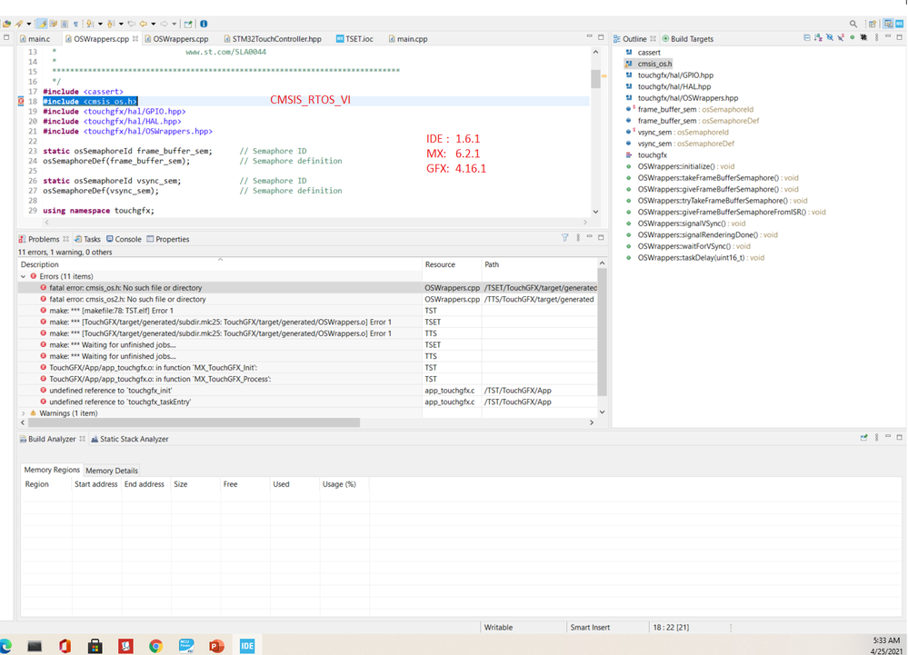

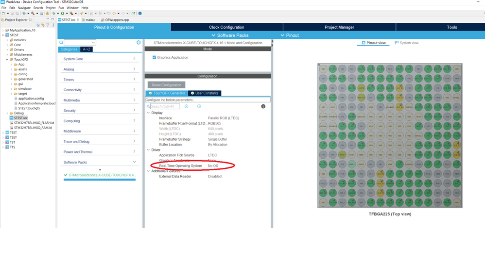

@KRega.1​ ,@Romain DIELEMAN​  I had the same problem (MX_TouchGFX_Init), then I tried a simple blank project for STM32H7B3I-DK starting from MX v 6.2.1 but I've the attached errors:0693W00000AMRRhQAP.png0693W00000AMRRrQAP.png0693W00000AMRRwQAP.png
Do you wish to work with or without an OS ? Your screenshots are confusing :grinning_face_with_sweat:
Could you create a new post with your question ? It is not really the same as the one in this post.
/Romain

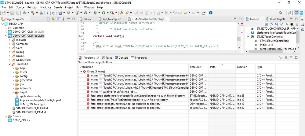

I'm facing the same exact problem as mentioned in this thread in the start.
Versions of software's
STM32CubeIDE 1.7.0
STM32CubeMX 6.3.0
TouchGFX 4.17.0
I'm using STM32H757I-eval board.
And I'm not using RTOS.
I have tried creating the project from the STM32CubeIDE and STM32CubeMX
But still I'm getting the same exact errors as the screenshot in the beginning.
I have tried all possible ways I could but I'm not able to solve the issues.
Please do provide me a solution for the same.
Regards.

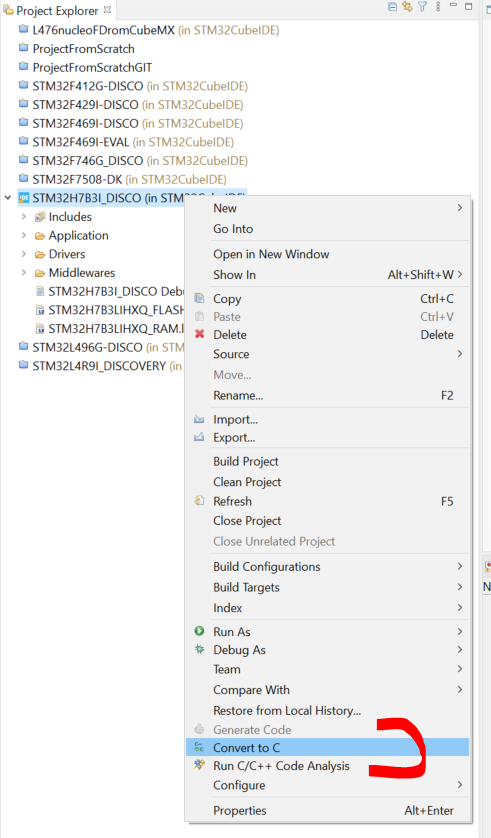

Could you check if your project is C++? When you right click on your project in the tree view in STM32CubeIDE, look for "Convert to C" or "Convert to C++" option. You need to use C++ to work with TouchGFX.
/Romain
I have converted my project to c++ yet the errors remain the same.
0693W00000FB89mQAD.pngRegards
I am not accustomed to dual cores yet so I would advise to create a project from TouchGFX Designer with the TBS for the STM32H747 disco board and compare its configuration.
