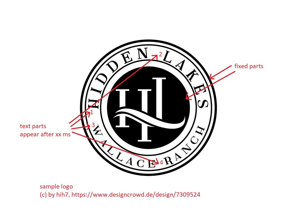

The outline and a symbol in the middle of the logo is fixed all the time, just some other parts apear with every new picture.
My problem is that I see the changes of every image on the fixed parts of the images.

I don't need a fast running animation or something like this, I just want a short intro logo were some text parts appear after some time.
Attached a sample logo from the internet were I tried to describe my needs.
There are some pictures and at the end of the animation is the full logo visible.
I also tried it with different screens and a wait time and screen change on my own, but there is the same behavior with the short refresh flicker on the fixes parts (outer circle and inner symbol).
Do you know a better way to do this short "animation" flicker free?

I can see that the text is following the outline of the circle but it's important to understand that the pixels updated when the text appear will be a rectangle encompassing the text.

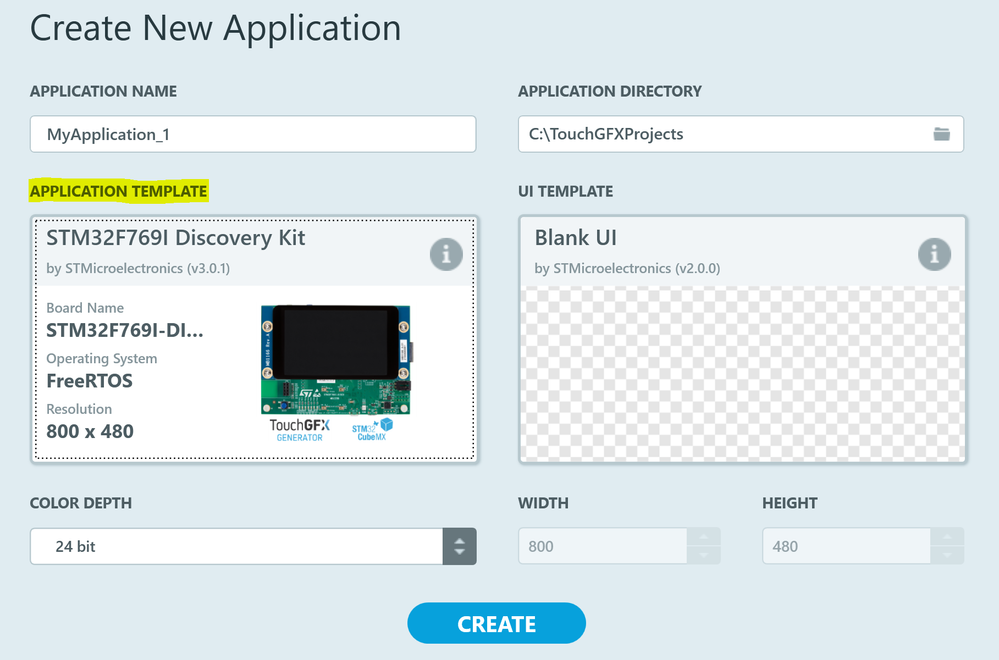

AT stands for Application Template, it is basically the hardware code on top of where the GUI will be placed. For instance on the following picture, you can see the selected version is 3.0.1.

Yes, it's the AT V3.0.1 for the STM32F769I Disco but I use now a different DSI Display with the same resolution.

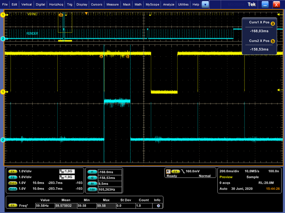

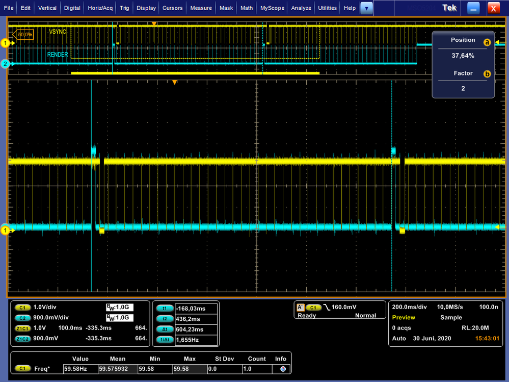

I added the Render Pin to the begin/endFrame() and the VSYNC is already in the TearingEffectCallback as you explained.
Yellow = VSYNC PIN
Blue = RENDER PIN
^ Here we see the ~600ms delay between two images (animated picture).
Otherwise the framerate is ~60Hz
^ Here the same screenshot with more zoom to the first event.
For me it seems that the rendering time isn't the problem.
What do you think?
