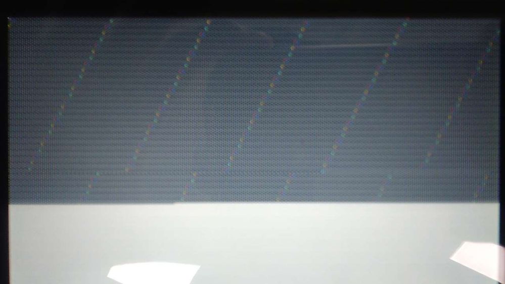

At this moment I have this:
This image should show colors bar (a function from video decoder) and we can see a few pixels like it should be.
I'm checking DCMI settings and synchronization. If I move camera position this screen has little changes, but with this beautiful pixels!
Thanks
Martin KJELDSEN
Chief III
How are you doing on this? Did your checks turn up anything? How many bars did you expect there to be? There may be an offset issue - That's typically indicated by the slanted lines. Maybe your dynamic bitmap is one pixel too wide.
/Martin
Hi Martin,
Well about the bars the problem was the synchronization in HSYNC, because I was expecting that DCMI peripheral should do this, but it doesn't.
My camera format is YCbCr, so I needed to implement in code this sync and then convert, in code too, to RGB888 format.
The problem about this is the frame rate, which I could reach only 10 FPS (because the conversion YCbCr > RGB888 done in code).
In TGFX side, I add a Dynamic Bitmap and every VSYNC interrupt I do the conversion and invalidate the image.
Another think is that the camera has more resolution than my TFT, so currently I show only a part of full image, because I think if I downscale I need more processing and could reduce even more the FPS.
Regards
Further processing the image would probably slow down things considerably, i agree. So, actually, some ST chips support in-hardware-YCbCr decoding directly into the DynamicBitmap memory area.
/Martin
