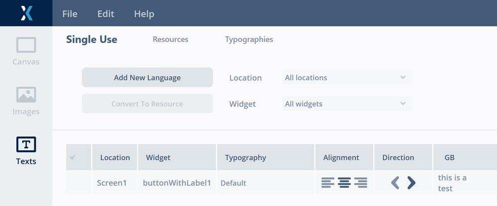

Hello @markH​ ,
In TouchGFXDesigner 4.18.1, if you want to display 2 lines of text on your FlexButton, you can simply go to the Texts tab, then add manually the new line for the resource you want :
Hope that this helped,
/Yoann

‎2022-04-07 12:45 AM
Yes thank you that works!
