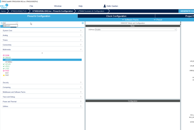

Hello @bytespectrum ,
It should be possible to use only one lane but you have to make sure you get enough bandwidth.
You say that you changed lane in STM32CubeMX but if I look for DSI on the provided STM32U5G9J-DK1, it seems to be deactivated:
Can you run me through the steps you took to activate one lane?
Regards,
Gaetan GodartSoftware engineer at ST (TouchGFX)

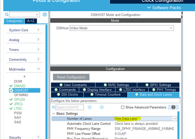

I am using TouchGFX Designer to generate my firmware for STM32U5G9J-DK1 board.
I have attached my firmware which is working good with 2 lanes in same board.
As highlighted in below screen shot, I am changing data lines to one but it is not working.
Thanks,
Tarun

I have looked at your project.
When changing to one lane, the value is correctly changed from DSI_TWO_LANE to DSI_ONE_LANE in main.c at line 434 :
hdsi.Init.NumberOfLanes = DSI_ONE_DATA_LANE;
However, I have not been able to compile your program in either cases.
I don't know how your project have the DSI enabled but not mine.

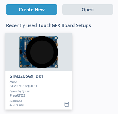

To create your project you:
  1. open TouchGFX Designer
  2. click on Create new
  3. Select STM32U5G9J-DK
When I do that I end up with a project that I can compile and that disable DSI.
If you followed the 3 steps above, did you select the project with FreeRTOS or with ThreadX?
Which version of TouchGFX and STM32CubeMX are you using? The latests?

TouchGFX version: 4.24.0
STM32CubeMX version: 6.12.0
Immediate problem that I noticed is, you are selecting wrong board. Please select STM32U5G9J-DK1 instead of STM32U5G9J-DK.
I used below board.

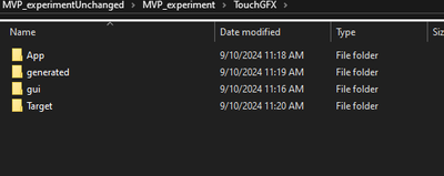

I am looking at why you are not able to compile my project.
Thanks,
Tarun
September 11, 2024
Hi Gaetan,
Here it is compiling fine. Which error you are getting while compiling?
Thanks,
Tarun
