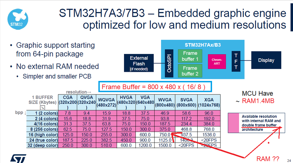

STM32H7B3xI is coming with approx . 1.4MB Internal RAM .
What max TFT resolution it will supports with Internal Frame Buffer (Single Buffer)
only with single MCU?
Frame Buffer = Number of Pixels x ( Color Depth in Bits / 8 )
Frame Buffer = 800 x 480 x ( 16/ 8 )
Frame Buffer = 768000 Bytes
Frame Buffer = 750 KBytes

Few days back , I have attended webinar "Explore Graphics, Artificial Intelligence, and Voice UI Applications with the STM32H7A3/B3" .
How 1.4MB RAM is segregated ?
Can you please help me understand below image ?
Why only 510 Frame Buffer in used for Frame Buffer ?
Karan
Hi, i'm confused by your arrow and your comment on 510 Kb ram. But, if we do the math for the 510 case (480x272, 32 bpp)
( 480 x 272 x 4 ) / 1024 = 510 KB - You could fit two of those in internal RAM with memory left to spare
@Martin KJELDSEN  (ST Employee)
Frame Buffer = 800 x 480 x ( 16/ 8 )  = 750
But , Why I can't access 750 KB RAM (From Internal RAM) as per slide image of 1.4 MB RAM ?
Karan
