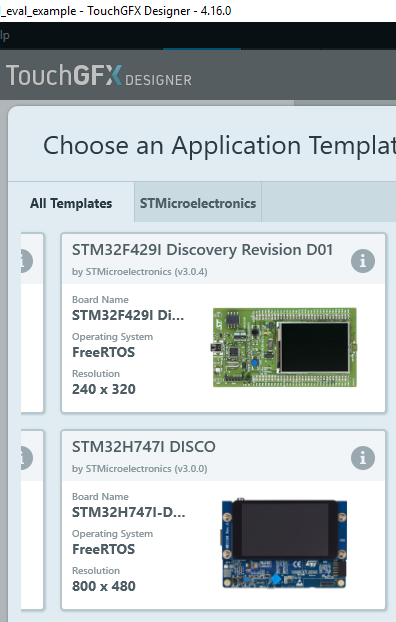

it seems that also with version 3.0.0 for H747Disco there is no the possibility to create *.ioc file. Can you confirm that?
I'm using TouchGFX Designer 4.16.0.
0693W00000AOKxzQAH.pngThank you
Yes the ioc has not been implemented in the v3.0.0 as we wished due to issues with STM32CubeMX and dual core support. It will be with the next version we are working on (most likely 3.0.1). It should be release along TouchGFX 4.17.
