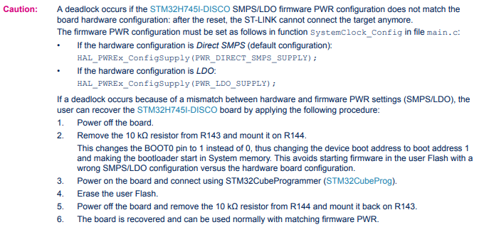

I tried to flash a sample application from TouchGFX on a STM32H745I-DISCO. Application template was for the STM32H750B-DK since there isnt one for the H745 and I wanted to see if it would work.
I got a white screen and the usb programming is not working anymore. I get an error about erasing the memory segments.

Hi @Community member​ ,
It is possible that a deadlock occurred on your STM32H745I-DISCO. To unlock it, please follow the procedure described in UM2488:
0693W000005ATKeQAO.png> there isnt one for the H745
