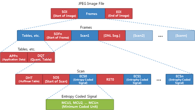

As a result of comparing headers that display images normally and headers that do not, it seems to be related to the number of marker ID SOS (Start of scan: 0xffda).
The images displayed normally had only one SOS, but there were several images that could not be displayed at all.
How should I handle images that are not displayed due to these headers.
