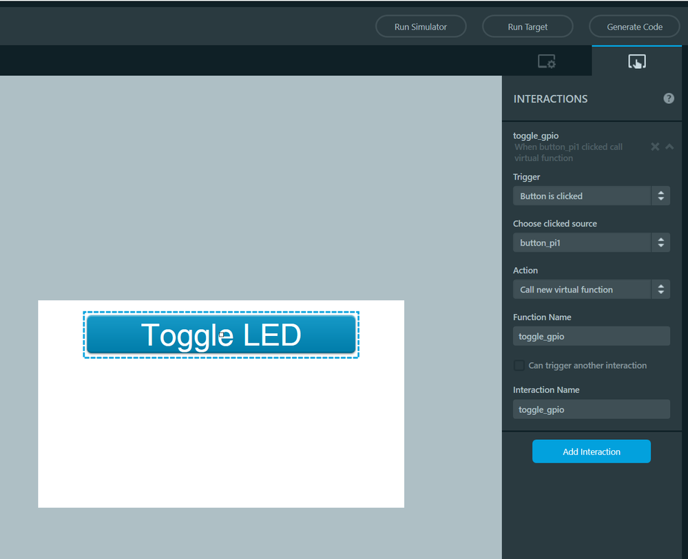

I'm really struggling to implement easily a GPIO function, even with the tutorials provided.
I'm trying to use the GPIO class set (GPIO_ID id), but how ?
It's not very well documented, there are no examples provided.
https://www.touchgfx.com/documentation/html/classtouchgfx_1_1_g_p_i_o.html
I'm trying to set a GPIO pin (I1) to HIGH via the press of the button called "button_pi1" on my UI.
I'm calling a new virtual function called "toggle_gpio".
Here is the code generated in screen1viewBase.cpp :

‎2019-12-17 4:06 AM
Here a screenshot of TouchGFX designer :
‎2021-11-26 2:32 PM
I also have the same issue. I didn't get any documents or code for how to write gpio in touchgfx. how to use touchgfx gpio::set, clear. please provide some examples
