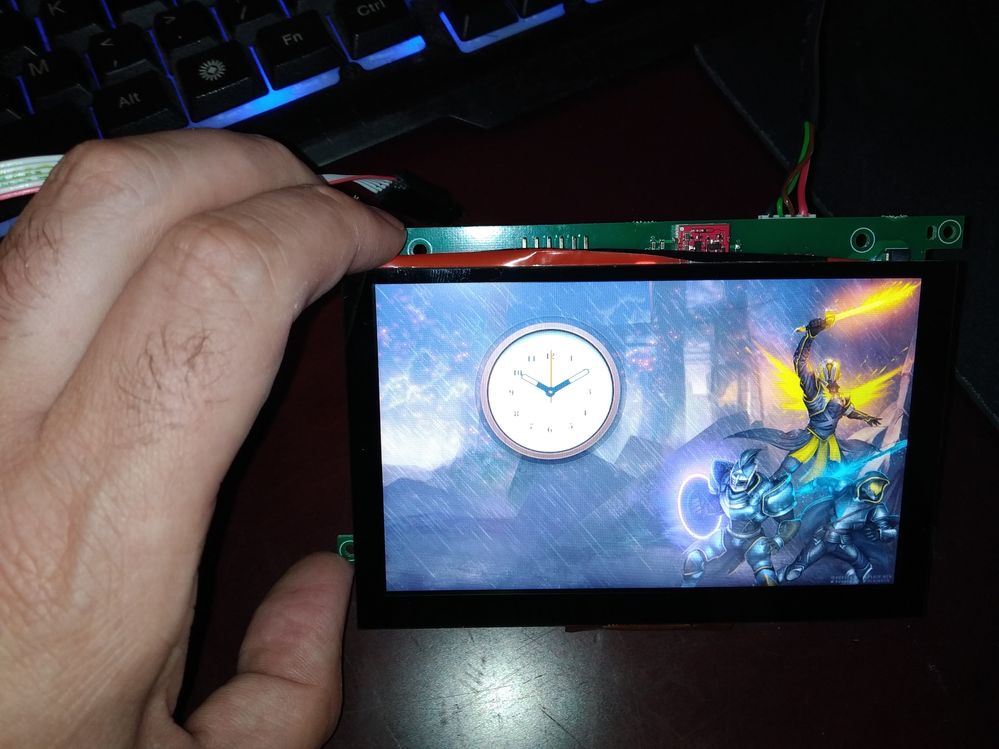

I am building a custom board based on the STM32F746's discovery.
I have already used the STM32CubeIDE 1.1.0 with TouchGFX 4.12.3 om discovery and everything is working fine.
Custom board has the same hardware with discovery but we are using different TFT screen (attached PDF).
The TFT on my board displays:0693W000001pKYnQAM.png
I am not sure about the LTDC parameters based on the new TFT. I have set the below:

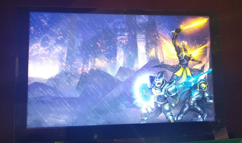

SKokk.1
Thank you for your answers.
I fixed the parameters but still problem. Then i changed the Pixel format to:
pLayerCfg.PixelFormat = LTDC_PIXEL_FORMAT_RGB565;
And it worked.

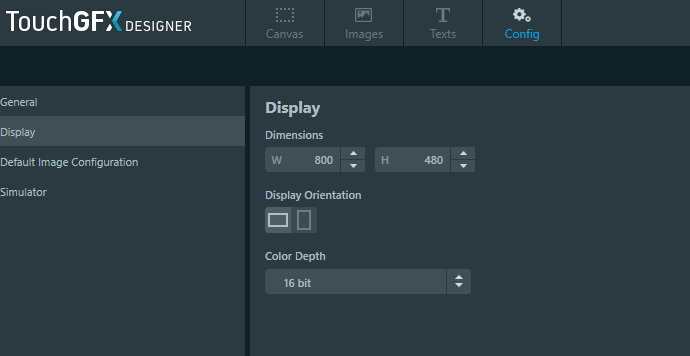

On TouchGFX project the Pixel format is "locked" to 16bit. Is there a way to change it to 24bit or i should create new TouchGFX project?
Hi
Just Create new Touchgfx project and ​then try...
Karan​
That does look a lot better...
SKokk.1
Worked with RGB888 setup too, thank you guys.
