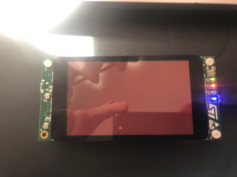

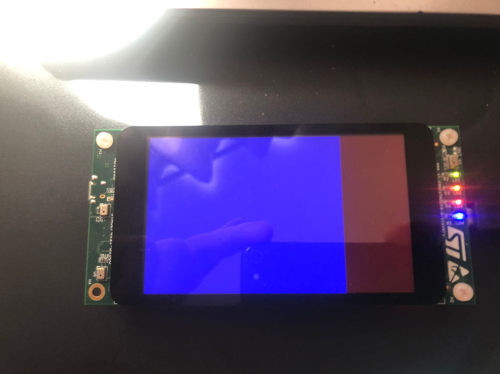

I have created a simple project. So far only has 3 screens, each a box filling the screen of different colours. I simply use 'Interactions' to toggle between each screen every 2 seconds. On start-up the complete screen is drawn. On each subsequent screen change only the left 3rd of the screen is re-drawn, leaving the right quarter the same as on start-up.
The simulator does not have this issue.

Hi Matt,
How did you create this project? Unfortunately, right now there are some inconsistencies between how projects look when created from CubeMX, CubeIDE and when you create an application straight from within the TouchGFX designer.
If you choose the application templates from within the designer, things should be working for you.
