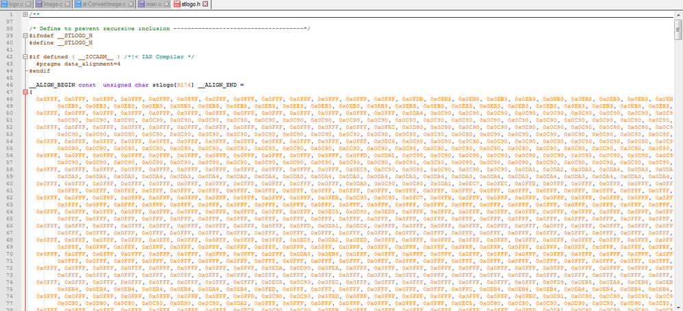

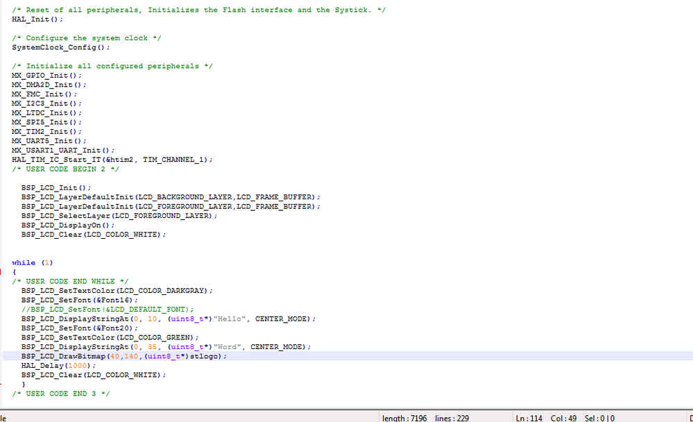

ibrahim
Posted on September 16, 2016 at 10:32

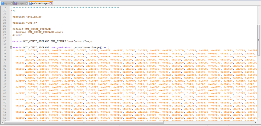

Thank you for the answer, but after generating code in .c with BitmpCV.exe I just copy the table in my .h file
stlogo.h
#ifndef __STLOGO_H
#define __STLOGO_H
#if defined ( __ICCARM__ )
#pragma data_alignment=4
#endif
_ALIG_BEGIN Const unsigned char stlogo [2795] _ALIGN_END {
copy of the table by generating BitmpCV.exe
#endif /* __STLOGO_H */
After my main.c
#include ''stlogo.h''
int main (void){
while (1){
BSP_LCD_DrawBitmap (40, (uint8_t *) stlogo);
0690X00000605T8QAI.png With the example file STM does it work but with my table it does not work. thank you my results
http://www.mediafire.com/view/7wgy8jh8a16j7sv/IMG_20160916_105009%5b1%5d.jpg

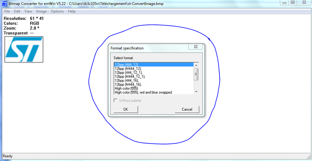

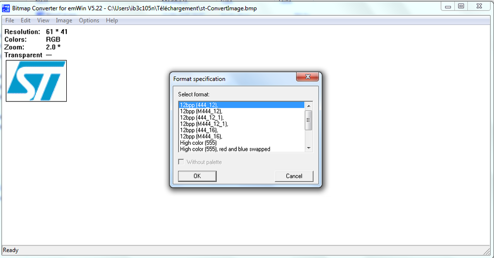

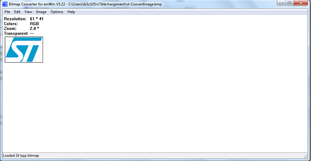

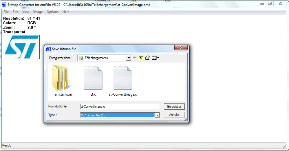

ibrahim
Posted on September 16, 2016 at 14:18
Hello
, here are the
steps
for
how I
try to do the same as
the example of
STM
1st step: I generate my
in table .c
with
BmpCVt.exe so I'll have my table soon after they are on 8bit 0xFF
and
soon
both
16bit
0xFFFF.
2nd step:
I open
my
file
stlogo.h
I brought
to STM
sample file
in STM32F4xx_DFP/2.9.0
/Projects
STM32F429I
-Discovery
/Examples /BSP/Inc
With
their
table
it works fine I displays the ST logo. but if I want to put my table and I create with BmpCVt.exe clears their table and I put my table. it gives me nothing and the display will give me any results

This is experiment with BMP internal data format.
If the experiment
will succeed
, I made a template for LIC.
Corrected code, format R5G6B5, in attachments.
Try it and
let me know
the results.

ibrahim
Posted on September 16, 2016 at 17:50
it was successful but it gave me an inverted logo with color green and orange

Posted on September 16, 2016 at 18:01
And try this attachment with inverted R/B colors.

ibrahim
Posted on September 16, 2016 at 18:08
How can I change color details and how do I generate a table as you did for another
logo,
you can show me
the
way
Thank you
riuson
Posted on September 16, 2016 at 18:47
See attachments here.
