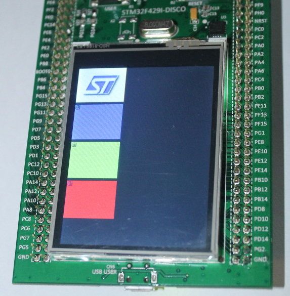

Also try convert 3 images filled with one color: only red, only green, only blue.
I have STM32F429I-Disco, but I don't have working application with BSP to check my assumptions.

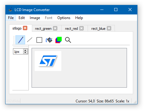

Posted on September 18, 2016 at 16:48
Ok, I have completed project with BSP and checking settings!
See attachments here.
BSP_LCD_Init();
BSP_LCD_LayerDefaultInit(1, LCD_FRAME_BUFFER);
BSP_LCD_SelectLayer(1);
BSP_LCD_SetBackColor(LCD_COLOR_WHITE);
BSP_LCD_Clear(LCD_COLOR_BLACK);
BSP_LCD_DrawBitmap(0, 0,
reinterpret_cast
<uint8_t *>(&stlogo));
BSP_LCD_DrawBitmap(0, 70,
reinterpret_cast
<uint8_t *>(&rect_blue));
BSP_LCD_DrawBitmap(0, 70 * 2,
reinterpret_cast
<uint8_t *>(&rect_green));
BSP_LCD_DrawBitmap(0, 70 * 3,
reinterpret_cast
<uint8_t *>(&rect_red));
I have described this in article
http://www.riuson.com/blog/post/generate-image-for-stm32-discovery-bsp
