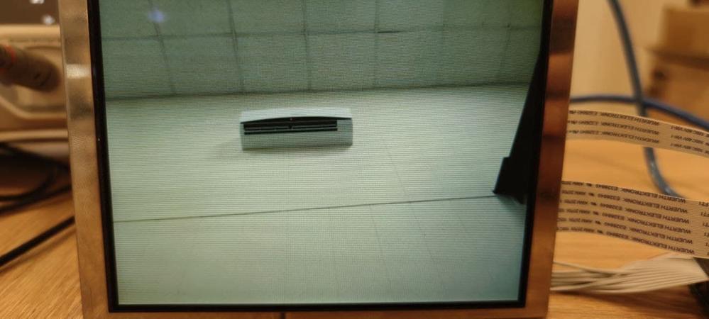

Once upon a time I did a project for displaying images from a camera OV5640 and STM32H743XIH6
Then I still used TrueSTUDIO and the project was created with version HAL 1.3.0
Now I have successfully translated it to STM32CubeIDE (The picture is still good)

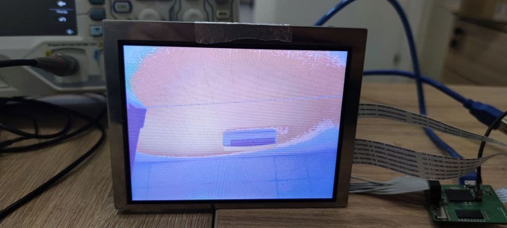

I have now re-generated the project using CubeMX with HAL version 1.9.0
And I get the wrong image (I haven't changed the periphery settings)
After that, I generated a project using CubeMX with version HAL 1.3.0
And I get the wrong image again
I think the generated TrueSTUDIO project was somewhat different, I noticed that the CMSYS files are named slightly differently
Perhaps someone has already encountered a similar problem and will understand everything from the photo
I attach 2 photos (good and bad)
I want to say in advance that the matter is not in the inversion of the high and low bytes of RGB565 (In this case, the picture turns green)
I have an assumption that the picture is shifted by 1 byte (but I'm not sure)
