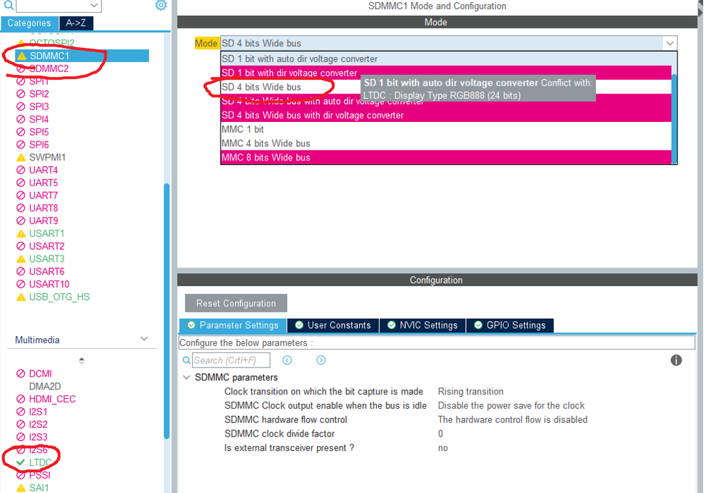

When configuring SDMMC1 in STM32CubeIDE, I get a warning that it conflicts with LTDC (RGB888). SDMMC2 does also conflict. Can someone guide me, how to resolve this conflict?
4 bit SDMMC1 and LTDC RGB888 do not conflict with each other.
The only conflict is with other modes of SDMMC1, which is why the message is a warning and not an error.

Warning can be ignored. It's letting you know you won't be able to use both at the same time.

But I need to use both at the same time.

176 pin package gives the same warnings for SDMMC1 and SDMMC2 in conflict with LTDC.
The demo installed on the board uses LTDC and SDMMC1. My question is: how can this be achieved?
