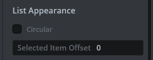

Indeed it's not possible with a scrollList item. However it's possible with a scrollWhell when playing with the selected Item Offset.
Can you try with that ?

If you try ScrollWheel, just be aware that when you stop scrolling, you will get a SelectedItemCallback even if you haven't done a keypress on an item. See here. There is no differentiation between the SelectedItem callback and the AnimateTo callback.
