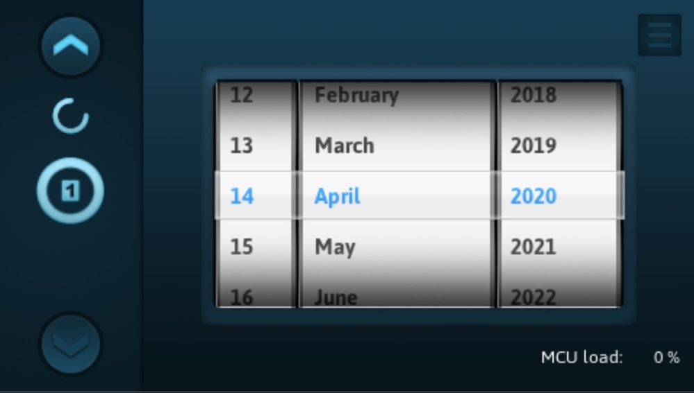

Oh I think I misunderstood your question. I thought you were talking about the position of each element no the value. To be honest, your question about seeing the next value without the scrolling widget confuses me. Do you mean you want automatic scrolling? Or are you looking for another widget to show your values?

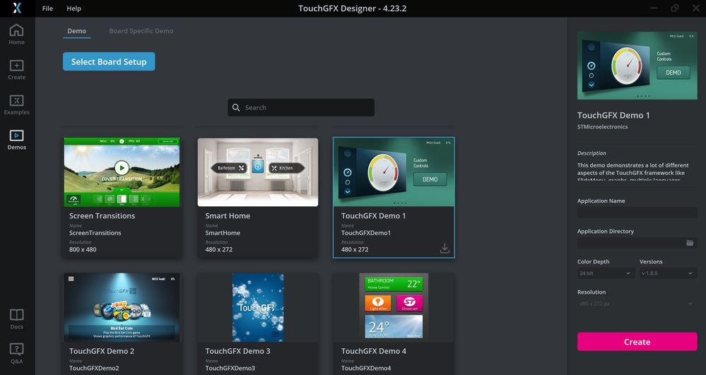

I think what you are looking for is pretty similar to a date picker. You can see one example shared by @Juliette CRESPO here , and also there is another one available in TouchGFX Demo 1.
