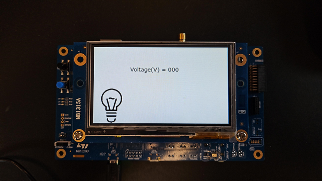

This is what my GUI looks like from a basic design.
This is what it looks like when I run the TouchGFX simulator(the right image is gone because I initialize it as false until it receives a signal)
This is the tearing image I am having trouble with(currently no inputs).

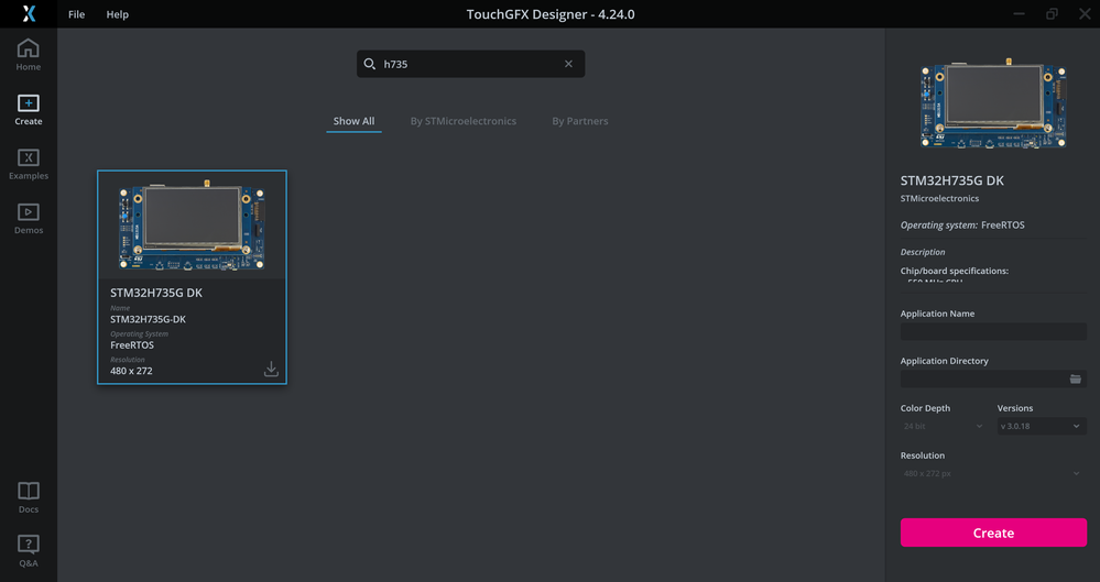

No, I didn't alter your code. I just changed my STM32CubeMX settings to add the pins you are using inside your project. I will explain my steps so you can follow:
1- Create a STM32H735G-DK project from TouchGFXSTM32H735G-DK TouchGFX Board Setup

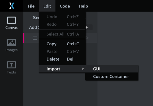

2- Import the TouchGFX application you have made:

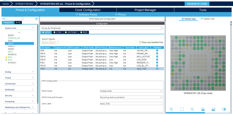

3- Add a random pin with the same name as the one you are using in your project and Model.cpp file (Input_Test):
Adding Input_Test pin
4- Run the project on the target:
Project running on the board
