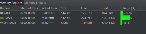

erkanc
Thank you for your response. I am using NUCLEO STM32G0B1RE kit that have 64 MHz clock and 32 Mbits/s SPI. But the external flash IC is in custom board. DMA is activated. Memory of my flash IC has 8 MB. And indicator of capacity is ~8% for ext flash IC.
***Also, keep in mind that scalable images are heavy widgets for MCUs, so there might be a chance that the MCU cannot render them fast enough when they are stored on the External Flash
It's possible.
My memory state is the following SS.
Is there any solution about this? I shared my MCU information.
