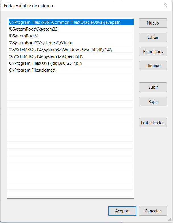

Hi. Do you have multiple msys.dlls in your path? From other tools.
‎2020-07-09 1:53 AM
I don't know for sure, I only have these in my path...
I formatted my computer a few days ago, I am recently installing everything again, so I don't have that many applications. Before formatting I had run TouchGFX and it worked properly.
