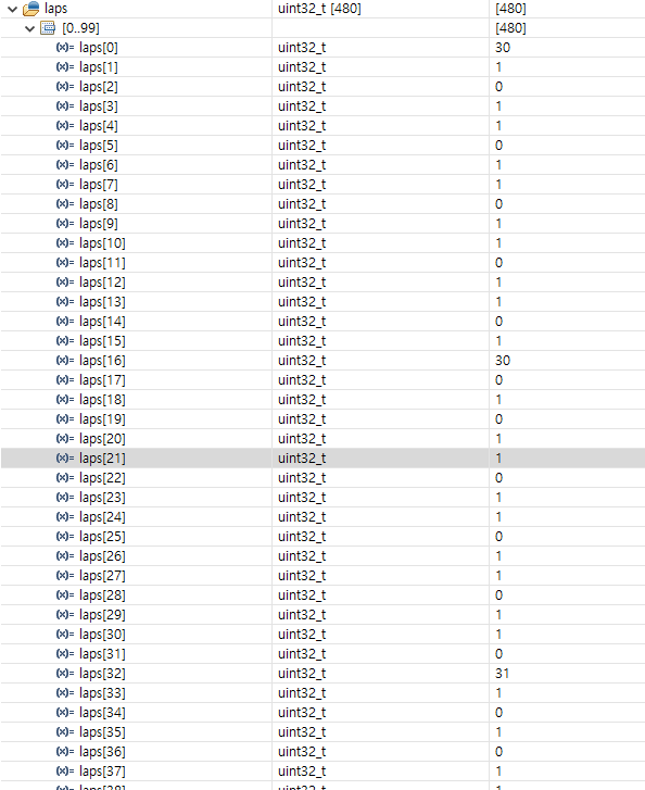

It took a long time to decoder JPEG images, so I measured the time.
[My code]

Time required each time the function jpeg_read_scanlines is called.
As you can see, it takes 25 ms to 35 ms for every 16 lines.
For this reason, it takes more than 1 second to load the 800 x 480 size image.
How can we solve this time delay?
1 REPLY 1
Converting more than 1 line at a time will almost certainly be more efficient. Increasing clock speed, or enabling cache can help. Compiling in Release mode will help.
There are chips within the STM32F7 and STM32H7 families with hardware JPEG decoding which is going to be much faster than doing it in software.
