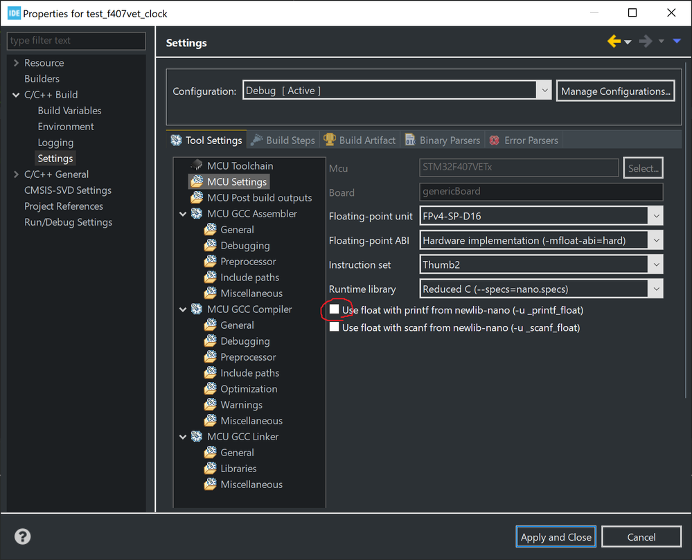

Often, float support within printf is disabled by default in order to reduce code size. Look for a way to configure it within your build settings.
@TDK​  this isnt settings for touchgfx
TouchGFX have special func for float read Unicode | TouchGFX Documentation
snprintfFloat(UnicodeChardst, uint16_t dstSize, const char format, const float value)Variant of snprintfFloats() for exactly one float only.
