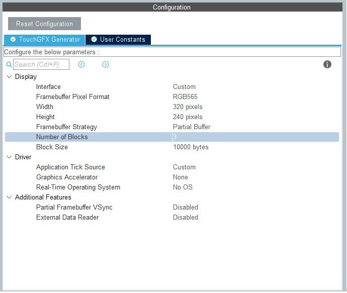

I can run the GUI on the screen, however, for some unknown reason, the touch does not respond. I have tested the touch function separately in the while loop and it handles the x and y coordinates correctly with the same code and with checking the touch press (I mean what you see below inside sampleTouch, just without "return true", because return true will exit the while loop).
Where is your definition of (0, 0), upper-left corner, or lower-left corner? I have tested both. nothing happens :(
This is my implementation inside "STM32TouchController.cpp":
bool STM32TouchController::sampleTouch(int32_t &x, int32_t &y) {
	if (XPT2046_TouchPressed()) {
		XPT2046_TouchGetCoordinates((uint16_t*) &x, (uint16_t*) &y);
		return true;
	return false;

My problem was solved. The problem was that the timer interrupt configuration was wrong and the interrupt was not occurring fast enough

I'm using a custom board, which both the LCD and its Touch have been tested using a different GUI library (non-TouchGFX library in another CubeIDE project). So the board and connections are fine (hardware is okay). I have used the partial buffer method which works fine and I can see the GUI on the LCD.
I use STM32CubeMX (6.2.1) to generate the code (including TouchGFX software pack 4.16.1) and I compile it using CubeIDE (1.6.1). So everything is provided by the CubeMX.

This is my setting of TouchGFX, I don't use LTDC. The LCD owns a controller (ILI9341). So I send data using SPI. MCU is STM32F407ZG. I call VSync function in a timer interrupt like below, also, I call the MX_TouchGFX_Process(); inside the while (1) loop. anyway, I don't think these steps are related to touch. I will investigate more.

extern void touchgfxSignalVSync(void);
void HAL_TIM_PeriodElapsedCallback(TIM_HandleTypeDef *htim) {
	if (htim->Instance == TIM3) {
		touchgfxSignalVSync();
hesam moshiri
