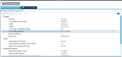

Slide transition and partial framebuffer strategy are not compatible.
You can set the partial framebuffer strategy on STM32CubeMX in the X-CUBE-TOUCHGFX pack :
