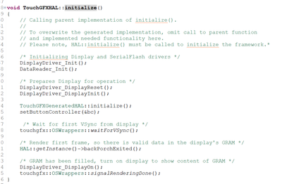

My problem is quite simple. I'm just trying to display text on the GFX01M2 LCD screen which is plugged into my NUCLEO-L452RE-P card.
I created a project from STM32CubeIDE and then imported the screen drivers from the NUCLEO-U083RC + GFX01M2 example on TouchGFX.
I have configured all the peripherals necessary to operate the screen (both spi, dma etc...)
You will find a photo of my microcontroller configuration.
I haven't found an example that uses this microcontroller. Can you help me ?
THANKS :)

2024-05-29 3:42 AM
This site doesn't really help me.
I'm using the GFX01M2, so I imported the MB1624ButtonController, MB1624DataReader and MB1624DisplayDriver files.
I see that in these files most of the files are already implemented and that I only need to change the names of certain variables which correspond to my pin names.
Using the debug I noticed that my program never executes and remains stuck in the TouchGFXHAL::initialize() function at this call: HAL::getInstance()->backPorchExited();
That this means ? I don't really understand this call.
THANKS.
2024-05-30 9:11 AM
You have copied this file from the U083 TBS (TouchGFX Board Setup).
Not all TBS are similar, they are board specific.
When looking into the U083 TBS project, I can see in the HAL.cpp file :
* Has to be called from within the LCD IRQ rutine when the Back Porch Exit is reached.
virtual void backPorchExited()
swapFrameBuffers();
tick();
I am pretty sure you have not implemented a LCD Interrupt request routine.
Overall, just copying files from another TBS is not the right way of creating a new TBS.
You should look at the link I provided earlier.
Regards,
