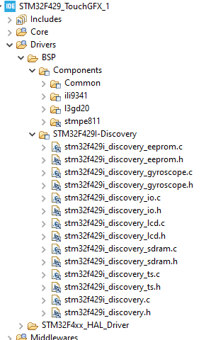

Okay, this may be difficult to imagine, but CubeIDE/CubeMX do not help you with BSP (e.g. touch, sdram, display - e.g. the most recent post you made etc).
So what you need to do is use that touchcontroller code, find the Board support package for the 429-disco and include the *_ts.c file, at least to get access to the BSP_TS* functions.
You can take a look at the f429-disco application template from the designer to see which files are in that project.
/Martin
Exactly, just link (drag&drop) files from Firmware package, remove unnecesary ones...
