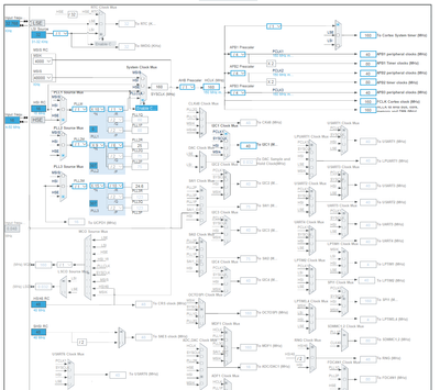

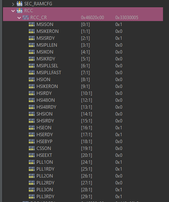

I have a Nucleo-U5A5ZJ-Q board which i replace the mcu with a STM32U5A9ZJT6.
I'm trying to use LTDC to control a 800x480 LCD (WF50FTYAGDNN0#) via RGB888.
Eventually running touchgfx, but I have fallen over at the first hurdle.
I have read many tutorials and forum posts and no one seems to have the same issue as me.
I started a blank project and followed this
https://support.touchgfx.com/docs/development/board-bring-up/how-to/03-display-internal
But my display remains a black screen, I then probed PD3 (LTDC_CLK) where I expected the 25Mhz clock signal that was configured, but saw nothing.
I also tried switching the pins "Max output speed" to Very High as I saw somewhere that this was required.
I then switched PD3 to GPIO_Output and toggled it to make sure connections are correct.
Is there something wrong with my clock setup? I tried a test of toggling a pin in the while loop with a 1ms delay and the scope says a full cycle took 4ms instead of the expected 2ms... but then I set the delay to 10ms and eveything is as expected on the scope.
Note about the display: it doesn't have Hsync and Vsync lines I assume this means it is permanently in DE mode and I can leave those pins floating from the mcu?
Any help would really be appreciated as I have been going at this for a couple of days now.

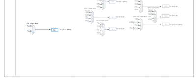

PhilipC

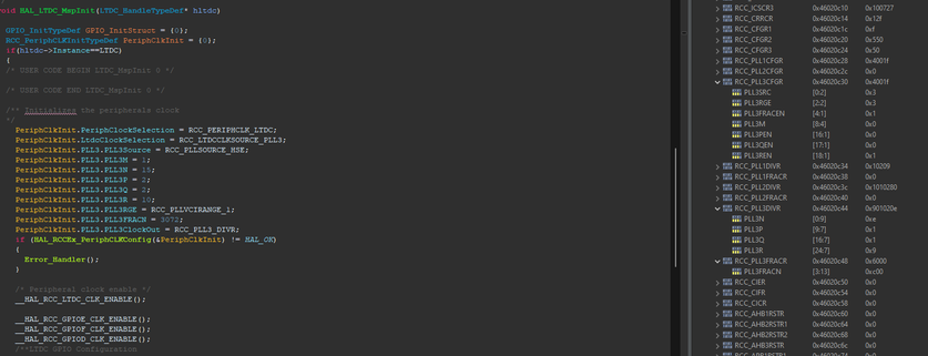

Ah sorry I flipped to PLL3 when experimenting stuff, the code does now also point to PLL3.
Does this look like the PLL3 registers aren't reflecting what the code says?

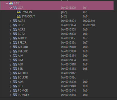

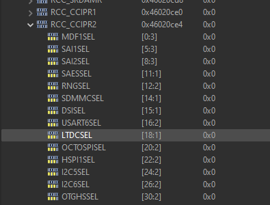

I just tried SAI2 peripheral as it is also on APB2, and it can write to its config registers fine.
I can also write to them and read them fine, so something specific to LTDC.
All the documentation I can find just points to LTDCEN being enabled before writing and nothing else, I'm really at a loss here.
SAI2->GCR = 1;
@STOne-32 is it possible this could have been fused like the U5A5 with the LTDC disabled? All peripheral registers are presenting as stuck-at-zero
@PhilipC can you provide a clear picture of the top markings of the IC you mounted.

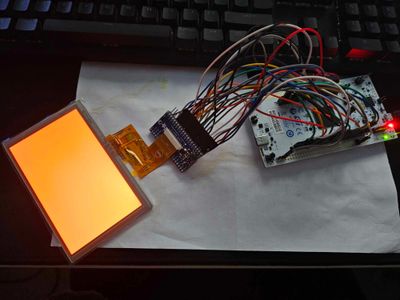

So I went to take a photo and couldn't believe my eyes...
I must have got the chips swapped at somepoint after removing the A5.
I have now swapped the A9 on and sure enough getting all the registers and a LTDC_CLK.
Thank you for your input and sorry for the confusion.
The display is now cycling through Black, White, Red, Green, Blue even though I have an empty while(1) but atleast it's a new problem.
I feel like a *** bashing my head against a wall for the past week only to find out I took the A5 off and put it back on... Thank you for you time @Tesla DeLorean
