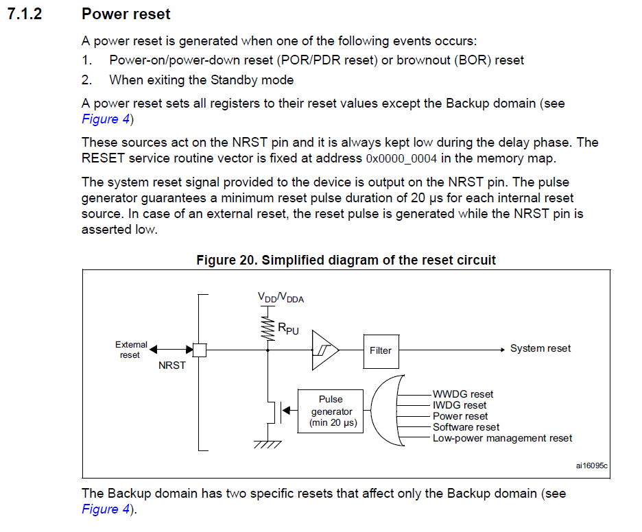

But now after wakeup if I perform a system reset ,the LCD works fine !!
In the reference manual ,it says that the wakeup from standby mode is exactly as power down reset ,so how come a system reset makes it work and not standby mode reset ?

also I noticed that after exciting the standby mode NRST  doesn't go Low ,is that right ?
in the datasheet the power circuit says that it should go low after exciting standby mode .
