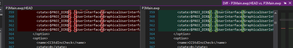

I've updated TouchGFX from 4.12.3 to 4.13.0 and I have the following issues:
The TouchGFX Generator changes the slashes from \ to / in the paths (e.g. include paths) of the ewp file (IAR)
  • I have a lot of unnecessary changes in the repository and a mix of \ and / in the paths.
  • Is there a possibility to tell the generator which slash it has to use?
The bug with the fonts is sill not solved -> see this thread
  • Is there a solution available in the next version of TouchGFX? At the moment I have to manually change the font files.
/Marco

Can you be more specific about the issue with slashes? I need concrete examples posted here.
I wouldn't rule out the "bug" you're mentioning being fixed in the final release either.
/Martin

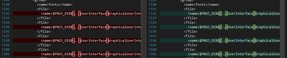

You did not send me a version. It is possible to download the current version through CubeMX -> see another thread
The new TouchGFX generator changes the slashes of the include paths (see diffs of *.ewp file)
... and also paths of the files itself
/Marco
I've just verified that you can actually get it through CubeMX 5.4.
It's actually the post-generate step through the designer that does this. Just commit it and let the post-generate script update it from now on?
/Martin

Is it not possible to change the post-generate script? We have had some problems in the past in a different project, when we used different types of slashes in the include path.
Based on this, we have to go back to version 4.12.3
