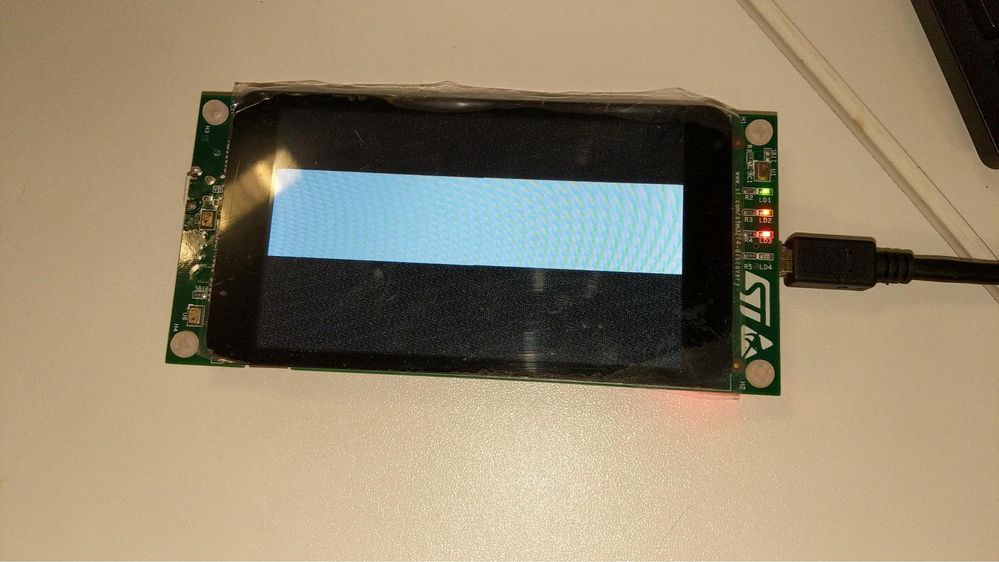

Thanks for pointing that I out, I forgot to include ledtask.c in Makefile!
Also, I had to add $(application_path)/target in the include path as well on line 171 of Makefile (I don't know if it's the right thing to do it but without it, ledtask.h is not being recognized in Model.cpp file).
Now, I am able to compile my code :) but the display is not working properly (PFA the image). If I disable the led_task, the display works fine (without hw integration). I even tried disabling the code inside the led_task but the issue is persistent. I don't know if it's something to do with the Makefile. PFA my project for reference.
‎2019-06-17 11:36 PM
You may have forgotten to program the external flash :)
/Martin
‎2019-06-17 11:46 PM
You're missing ledtask.c in your Makefile. You should take a look/diff with the Makefile from the original project (which is STM32F769 based).
/Martin
‎2019-06-18 3:11 PM
I am sorry Martin, I don't know how but the Makefile is not reflecting the changes I made earlier. Probably when I was zipping the folder, Makefile was open :expressionless_face: . Nevertheless, PFA the updated project.
Regarding the external flash programming, I am using the following command to flash the board:
make -f target/gcc/Makefile -j8 flash
I also tried the command shown below but there is no change (I also tried cleaning the project but no luck). Do I need to implement a different command other than this?
make -f target/gcc/Makefile -j8 intflash
‎2019-06-18 3:26 PM
Could you try adding some Boxes that don't require external flash, just to test this theory. Make them draggable. Just to see that you have a working application.
‎2019-06-20 9:21 AM
I made a new application with just a draggable box and it works. Also, as I mentioned earlier, when I remove the led task from main.cpp file, the application works fine (In this case the gui button is not able to control the led on board as the led task has not been created).
