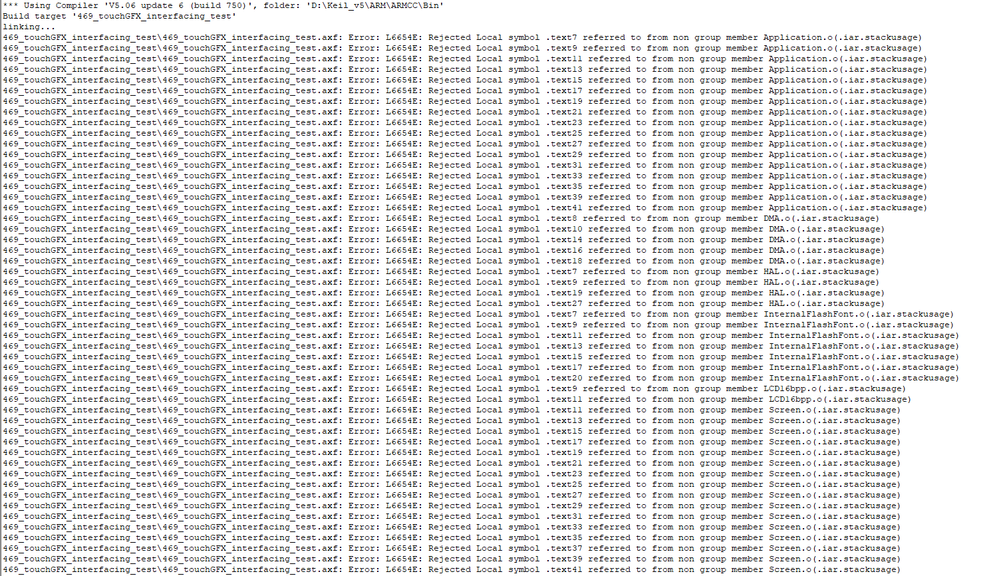

Hello all, I tried to integrate touchGFX to ​STM32CubeMX and I'm using keil to complie all the files. The complication is successful yet mountains of errors occurs during linking ! All errors are of the same type like this:
Error: L6654E: Rejected Local Symbol .x refered to from non group member x.o (.iar.stackusage)
Please help! I think I'm almost there!

Thanks a lot for your comment. I agree that it might be a bug since L6654E is so rare that few solution is released currently.
I disabled touchgfx in STM32CubeMx and deleted all related c files. I enabled the framework again and the error comes to be:
"Error: L6242E: Cannot Link Object xx.o as its attributes are incompatible with the image attributes.   ... wchart-16 clashes with wchart-32."
These xx.os are all touchgfx objects. Hence enum length definition conflict between touchgfx lib and STM32CubeMX library might be the reason.
I have to switch to AC6 compiler and use command line options to unify their length or just shift to IAR/SW4STM32 (which can be a better solution)...

Thank you for your sharing! It's rather impressive! I still worked on keil afterward and I switched to Arm Compiler Version 6.10.1. Here's the only error left:
469_touchGFX_interfacing_test\469_touchGFX_interfacing_test.axf: Error: L6683E: Merge Section TextFlashSection(texts.o) has an element size of zero
Furthermore, there're lots of touchGFX objects showing the warnings as below:
469_touchGFX_interfacing_test\469_touchGFX_interfacing_test.axf: Warning: L6776W: The debug frame in .debug_frame(stm32f4dma.o) does not describe an executable section.
as well as:
469_touchGFX_interfacing_test\469_touchGFX_interfacing_test.axf: Warning: L6869W: utils.o requested the Rogue Wave Standard C++ Library which has been removed from the product. This might cause link errors because libc++ is used instead.
